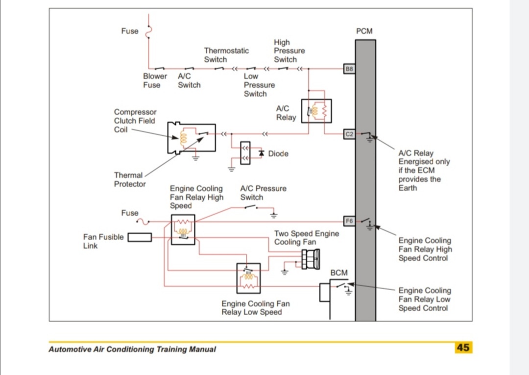

According to this diagram i found on a general a/c manual, the high pressure switch should only get voltage when all the switch before it is closed.

This diagram
- Screenshot_20220303_225045.jpg (104.8 KiB) Viewed 11754 times

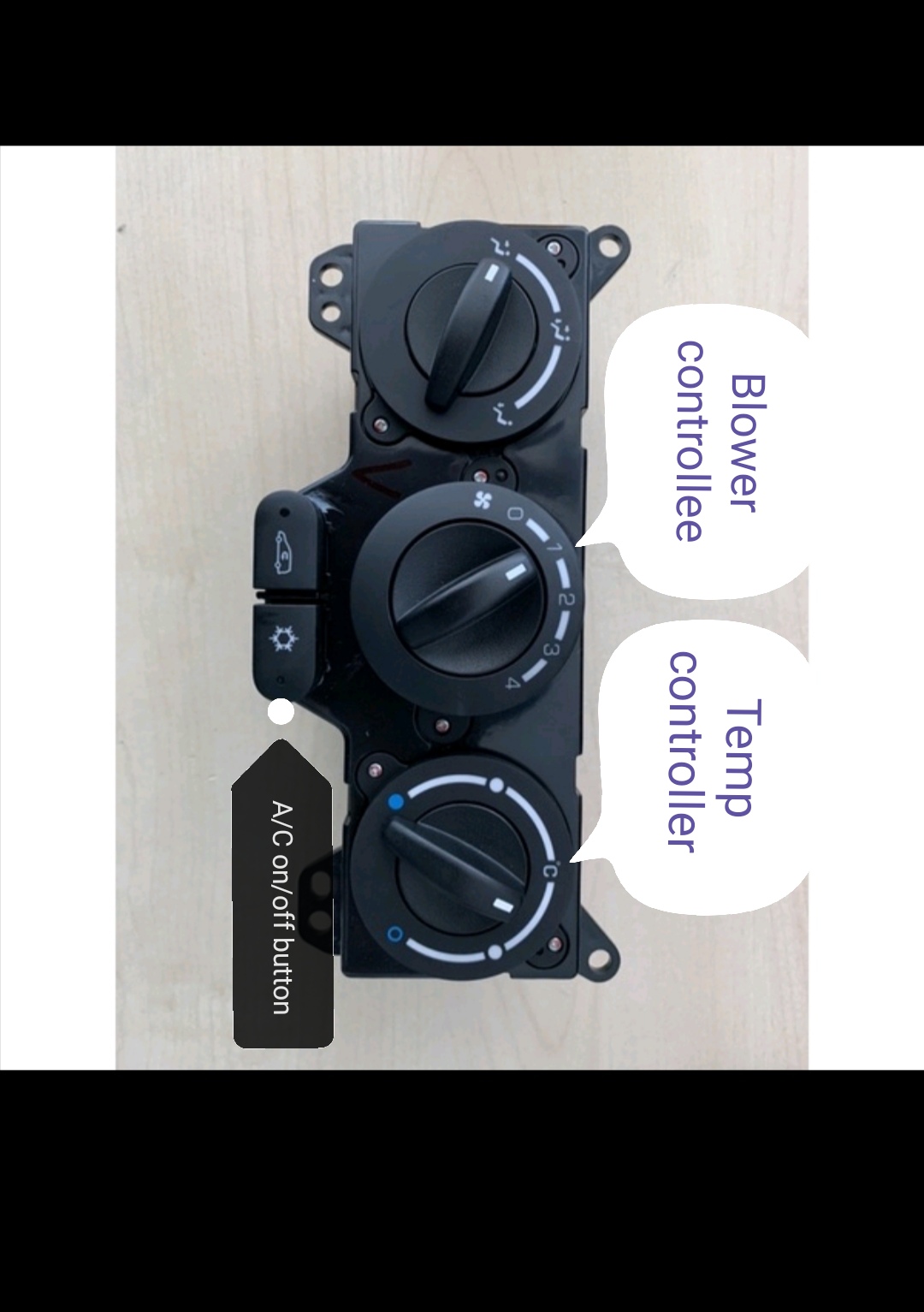

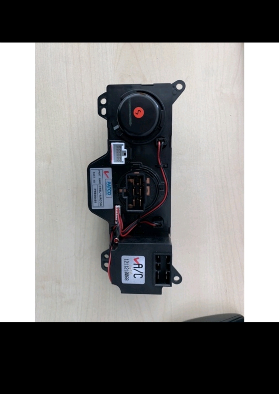

The A/C panel
- Screenshot_20220308_172949.jpg (206 KiB) Viewed 11651 times
- Screenshot_20220308_172648.jpg (202.96 KiB) Viewed 11651 times

I just noticed i can open the switches as there are screws there. I'll have to do some testing first. will update soon.
Just to confirm, does the compressor only turn on only if there is request from the switches inside the cabin? Can a faulty ecu cause the compressor to run?
Re: Why does my car 2 pin ac high pressure switch socket always have 12v on one lead
The wiring diagram you provided shows both a hi and low pressure switch. They may be combined into one switch.
