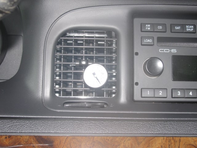

My cars ac runs decent on 92.5 degree weather it hits at 50degrees on the highway at the vent but when i pull into the drive through and the cooling fan kicks on to cool the condenser it will drop down to 45degrees in the vent right on the edge of the green in the vent gauge

how much colder can it get? does anyone actually get there vent temps in the green area or below it

"right on the edge of the green in the vent gauge"
are you able to post a pic of this gauge....

its a little thermomiter with a dial gage and near the 40 degree mark it has a green area from about 40 to 43 degrees
ill take a pic
ill take a pic

heres a pic of the ac thermometer
all the fan shrouds are there
it just runs a few degrees colder when the car is stoped
- IMG_2417-min.JPG (53.71 KiB) Viewed 23547 times
