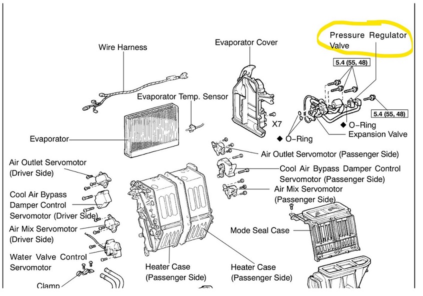

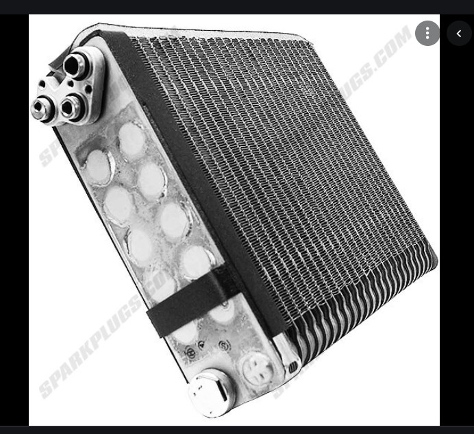

But wait theres more. There is also a "pressure regulator" valve attached to the evaporator piping (appears to be on the liquid line?). I have yet to figure out what this does and this is the only place it is mentioned in the service manual. Also, why does the evaporator have three openings/ports on it?
(see attachments)
pressure regulator.jpg (156.45 KiB) Viewed 24509 times

Man, the NVH clowns had a field day with that one. Servos to mix air, add heat and control everything. "cool air bypass" indeed.
To prevent the old ladies in costal california from clutching at their pearls, it is necessary to keep the vents from making the outlet air too "cold" . If it blew air cold enough to make your knuckles hurt we would be happy - but the "bring a sweater that restaurant is too cold" crowd is not.
I would start with making sure all of those servos are calibrated properly, and working.
You may be able to reduce the evaporator temperature somewhat by adjusting the POA valve (if it is adjustable) or tricking a sensor or two. Obviously you can only go so low, but making sure you get all of the cold air it is making is also important.
Get some evaporator pressure readings if that is possible. Do the low speed / high rpm test to rule out drive ratio issues. And keep posting results and information

You won't see a temperature drop across the EPR, there will only be a pressure drop.
I think the extra port on the evap is for an IHX integrated into the evap, basically a little heat exchanger transferring heat out of the liquid refrigerant and into suction gas, these are pretty common on current production cars, but they are in the suction line pipe, not in the evaporator. Evaporator room is usually too precious to fit something like this, takes space away from cross car structural beam, infotainment, glove box, airbags, etc.
This IHX is the same thing as wrapping a capillary tube around the suction pipe in commercial refrigeration, been done that way for 50 years, it increases the liquid subcooling (this is a positive thing) at the expense of increasing the suction superheating (this is a negative thing), the net result is a slight gain.
