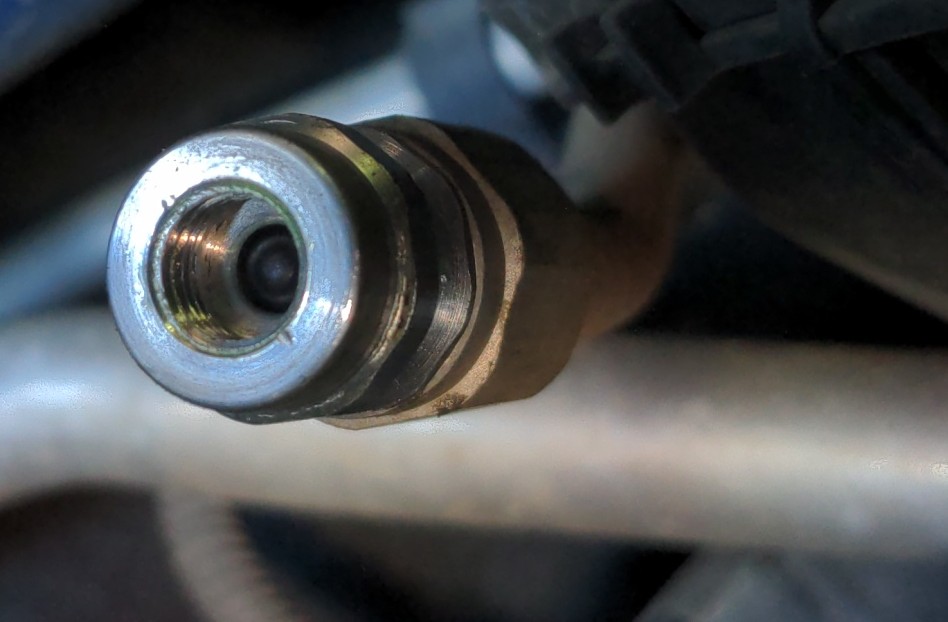

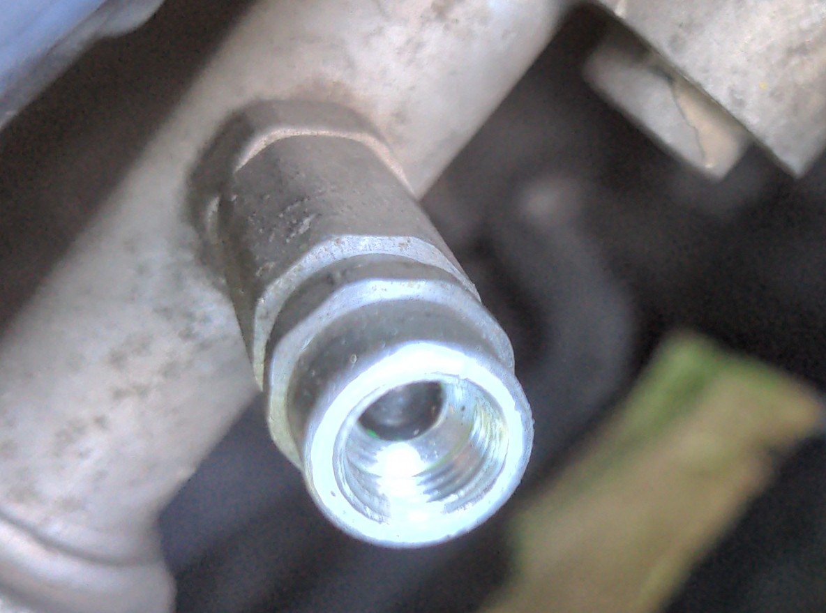

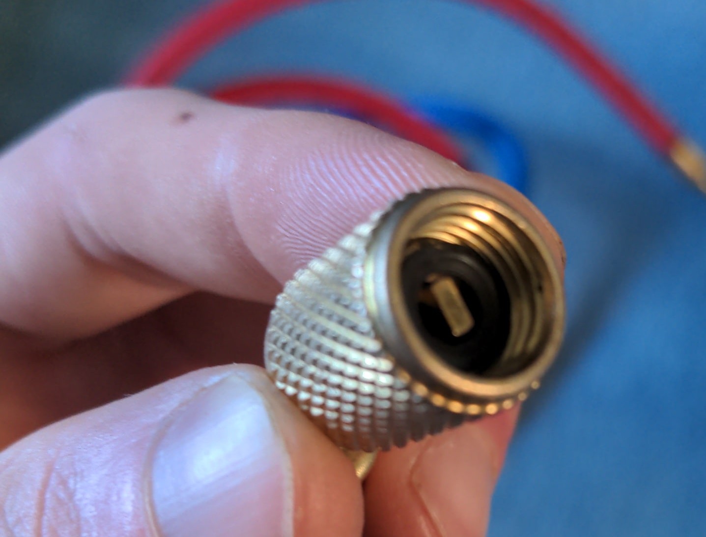

I have a gauge set which has connectors that do not fit onto my AC service ports.
It looks like the hoses that come with the gauge set are for an R12 refrigerant instead of the r134a which my vehicle uses.
I've attached some pictures, two of the connectors on the car and one of the connector from the hose that goes to the gauge set.
Does anyone know if an adapter is readily available so I can use this gauge set on my car.

Re: Help with manifold gauges
TBird, those won't work with his hoses. Need the old R12 to R134a couplers. He could buy couplers and hoses. But better just to buy a new set of gauges.
