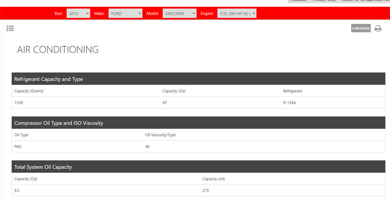

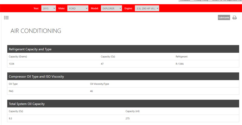

A few questions:
How do you know that it takes 26 ounces? Under-hood decal?

How do you know that it takes 26 ounces? Under-hood decal? Yes decal
