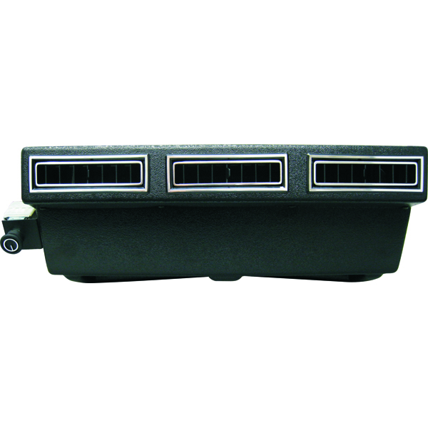

Re: Air system design for vintage car
Posted: Thu Jul 29, 2021 8:21 am
Here ya go, keep it simple. Just an example of many. Too many mfg make AC too complicated when it is actually very simple.
There are many companies making similar after market evaps, at least in the USA
If you Google "Vintage AC evaporators" I am sure you will be able to come up with something from your country. Racing concerns often have them, also.
If you take a Sanden 508 comp, one of these underdash units, a TXV, and the largest condenser you can possibly fit , along with a filter/drier, you will have very good AC. We do this all the time. Lots of custom work to fit up the evap and the condenser, and then of course fabbing or sourcing the brackets for the comp.
You can also get a ducted air box if you have room under/behind the dash and bring the ducts out to holes cut in the dash, or individual vents screwed underneath the dash, depending on preference
If you have a popular USA made vehicle some of the companies actually have an entire package for you which includes all the components you need, including brackets, etc. You can get the evaps AC only or heat/AC combo. By ripping out the stock heater box that may give you the room you need under/behind the dash.

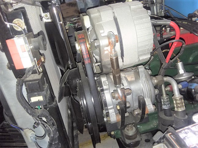

You will also have to consider if you have enough grooves on your crankshaft pulley to drive the comp. In an ideal world, the alternator and the comp should each have their own fan belt.
A year ago we added air to a 1947 Studebaker which only has a 1-groove pulley, with absolutely no way to make it a 2 groove pulley because of the way the harmonic balancer is made. And since Studebaker has been out of business for over 60 years, and because no one is making custom parts for this lesser-known vehicle. We had to make it work. We custom fabbed a mount for the Sanden, and then another custom fabbed mount for the alternator, which we put directly above the comp.
So we drive the Sanden from the one and only crank pulley groove, then since the Sanden has a 2-groove pulley, we drove the alt from the comp.
The crank pulley ended up not being large enough in diameter to make everything spin up properly, so we machined up a different, larger diameter crank pulley, using the stock pulley as our starting point. We obtained the smallest possible diameter alt pulley, and use a cogged belt because of that. A lot of work but we got it done. There is no kit for this, and we are the only ones with AC in this particular Stude truck model.
