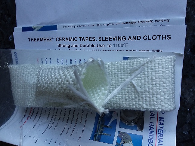

This for next time.
We did a job where the hoses were going to exposed to extreme heat. We insulated the hoses with woven ceramic cloth sleeving, and slipped it on before we installed the hoses. Pictured is good to 1100° but I believe they have an even higher temp rating product. McMaster Carr (Industrial supplier) was our source
smaller image000000(19).jpg (139.31 KiB) Viewed 35527 times
