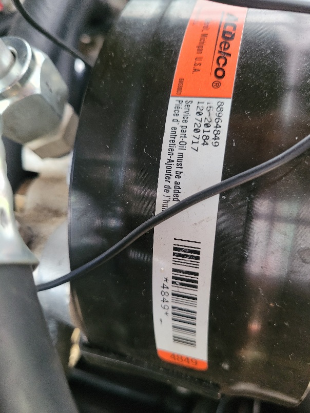

its a ACDelco 4849 here is a pic of it.
Re: R134a upgrade POA valve on a r12 system?
Posted: Sun Jul 18, 2021 4:56 pm
That is an R4. The actual part numbers are in the top part of the picture.
You can run that compressor without a POA valve, but you will need either an evaporator temperature sensor or a cycling switch on the low side.
Not clear where the TXV sensing bulb is located in that picture. Hopefully it is clamped to the evaporator discharge line and insulated.
With an R4 running 100% of the time you will push the evaporator well below freezing if the rest of the system is working properly.

bohica2xo wrote: Sun Jul 18, 2021 4:56 pm That is an R4. The actual part numbers are in the top part of the picture.
Thanks for the info.I have not seen a temp sensor and of course no cycling switch on the POA....should I install a cycling switch on the POA and set it around 25psi (or is it 30 psi for r12)? The compressor is cycling on and off but more off than on. Almost forgot it does have a clutch cycling thermostatic switch
The TXV bulb I'm hoping is clamped to the evap discharge line as its inside the box and sealed up with the black tape sealer stuff.
As far as freezing ...well the temps isn't all that cold was getting ready to look into but figured I would find out what exactly I have as the POA was confusing me....again thanks for your reply!

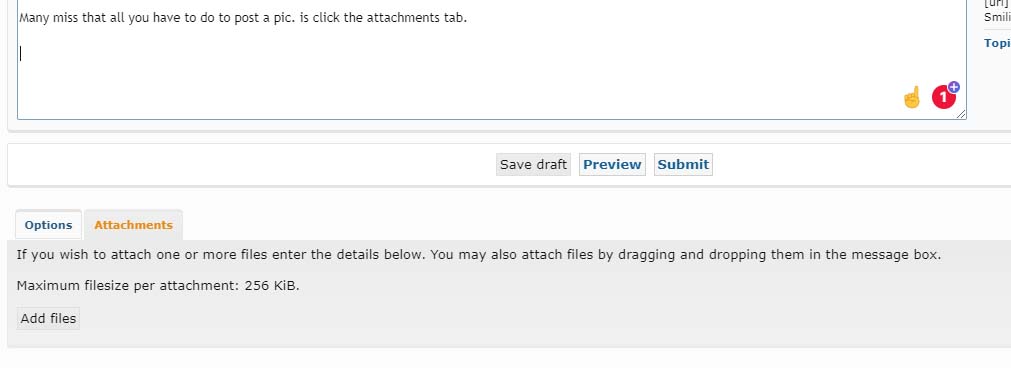

Many miss that all you have to do to post a pic. is click the attachments tab. Add file and select Place line.
