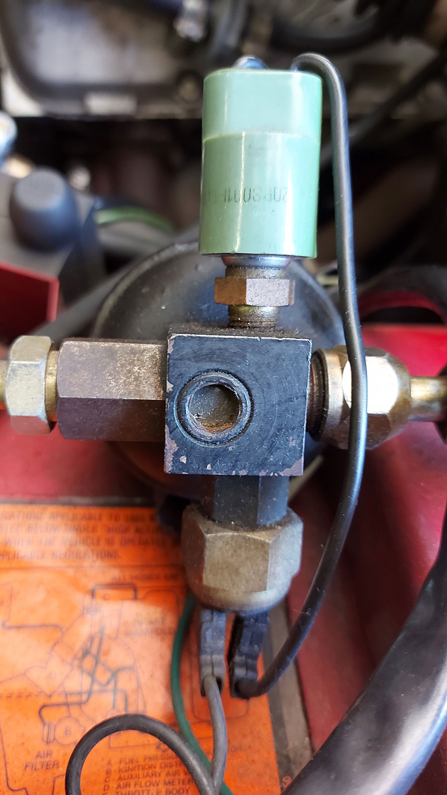

I'm in the process of getting my classic car's a/c up and running after years of not using it. Its a 1983 Alfa Romeo-GTV6. Its all original US Spec. York Compressor. Kenmore KMP accumulator. I'm replacing the accumulator and switches because they're old and I can't get the old switches to fit on a new accumulator and have them sit without getting in the way under the hood without adapters. I know the the old switches are low pressure (black) and high pressure (green). I want to the new switches behave like the old ones. Does anyone know if my old switches are in series or parallel? In my search this turns up as both a high pressure and low pressure switch. Would it be possible wire these together, then to the compressor like before?

Here's my old setup:

I am thinking series, lets see what others say

Switches could be for many things, you need to look at the wiring diagram for the car.
As I recall those Alfas had electric fans, so one switch may run the fan above a certain pressure.
There are switches with dual functions called Trinary switches available. This may let you use a single switch instead of two.
Really need to know the function of both switches before proceeding.

The switches in your picture would appear to be wired in series with the jumper wire that crosses the top of the dryer. If the green switch has more than one wire however it may have other functions.
Do you know the thread sizes of your OEM switches? With that information you should contact the site sponsor, ackits.com and see if they can find you the proper dryer. Tim at AC Kits has helped a lot of people with odd parts.
