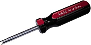

This is the removal tool I use

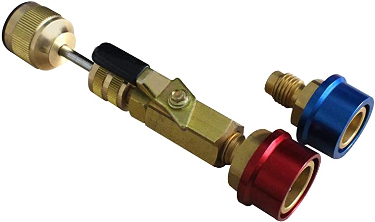

And yeah I'm looking for the tool that lets you replace the core without breaking vacuum or releasing charge. I have Appion core removal tools but they don't make anything for MVAC.

I've never seen a tool like that for automotive service ports, I heard Bigfoot has one, but loaned it to DB Cooper. I have a few different kinds for commercial 1/4 ports, my opinion they are not necessary for automotive. Schrader valves are bigger and interior volume is tiny.

you mean this?
Tim might carry it.....but they take up a lot of room under the hood. I have never used this tool. I suspect it would not work very well for vacuum, I think it is to change the core in a pressurized system. This gizmo is used by HVAC guys all the time for vacuum, but they are using Apion brand, a super quality brand
