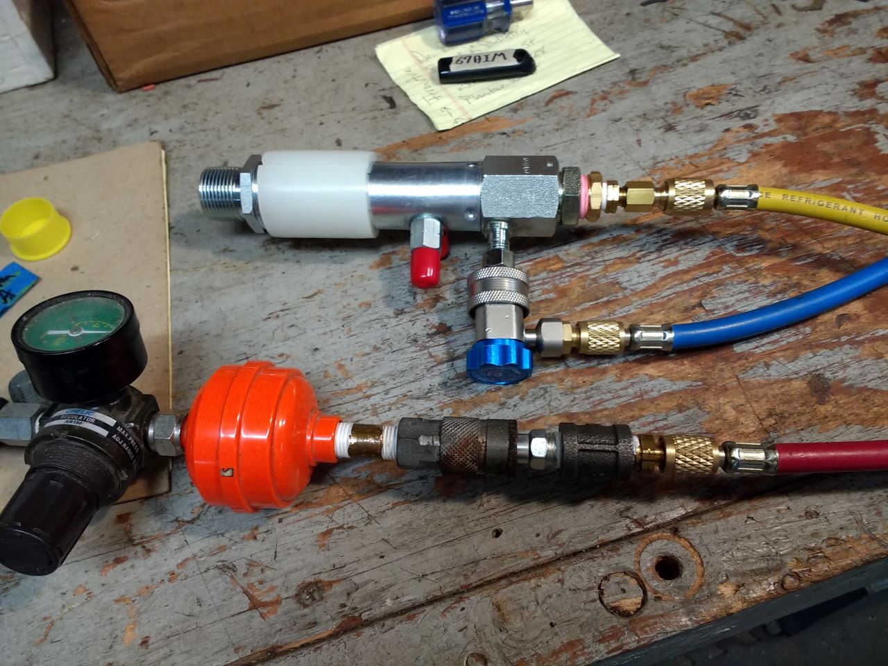

Posted: Fri Jun 25, 2021 10:46 am
by 3154tm
Tried to test the poa valve today. i set up the test rig as per the paper that has been referenced and posted here many times. the shop air is run through a drier and regulated to 75psi. as soon as i crack the high side valve on the manifold i can here air bleeding through the poa valve, there is no "pop". what am i missing. thanks.

Re: POA Valve Test/Adjust
Posted: Fri Jun 25, 2021 1:55 pm
I'm not the POA guy. I would think any sound of leaking air is just that. If air leaks, I would refrigerant would also.
