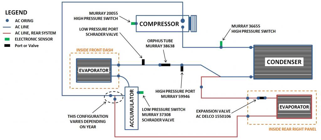

Thanks (V8Power) for giving me confidence in the R4 and (Cusser) for reminding me of the difference between series and parallel. And (Tim) I don't know if it would be ok to have two different types of expansion valves in the same system, or is that how they are normally set up, that I don't know ??
I hope that the illustration I included seems like it would work in your opinions. thank you !!!

Like Tim said, the rear normally has the TXV when you have 2 evaps off one compr.

No offense but I am gonna let others jump in here and take over. The questions that keep coming are the same
Re: Dual Evaporator Requirements
Posted: Sun Jun 06, 2021 10:47 am
Some just want you to tell them what they want to hear.
The last attempt to explain. Otherwise, it just gets repetitive.
Posted: Mon Jun 07, 2021 7:41 am
by gm76
This last attempt to explain is just the diagram I needed to go forward with my project. I thank you for that. I understand that the rear is normally a TXV. I was just curious as to why two orifice tubes in the system wouldn't have the same results. thank you
