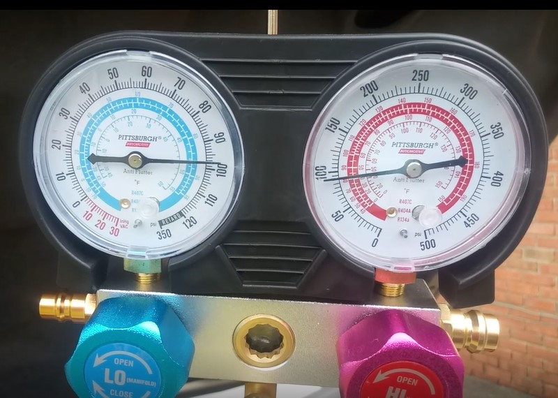

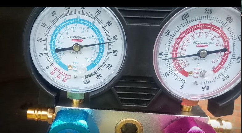

an this are the pleasures at 85°F and car @2000rpm
low side 89
high side 95
low side 95
high side 90
Also I noticed melted plastic in the A/C compressor pully I think it is from the Clutch but it is still turning ON.
(plan to replace it) but want to get the las bit of life out of it to diagnose my problem.
thank you.
AC ON
AC ON
ACoff
ACoff

The compressor seems to be dead. WHat eng and is this an American market vehicle?

Did the car suffer any recent front-end collision damage? Regardless, did you CAREFULLY check the condenser for leaks? Bear in mind that you need to check it in a darkened room using a UV light and a special pair of glasses for the dye to glow brightly. Otherwise, it's possible that you might not see any dye, especially if the leak is small.

This part of your post is somewhat confusing in that the car is turned off yet still running at 2,000 RPM. Probably a typo. So for our purposes, let's presume that the clutch is defective and isn't actually engaging, that the compressor itself isn't running and is dead (due either to internal or external causes) as Tim suggested earlier, and that you're currently reading only static pressures.
Given all of the above, I would approach this by recovering the charge (although many shops won't risk damage to their equipment if sealer is present in the system...again, check the can), evacuating, and recharging to spec (if the compressor will run, that is). That's the only way the gauge readings will mean anything for diagnostic purposes. If sealer WAS introduced into the system, and/or the clutch won't engage, and neither will the compressor, then you'll have to replace everything anyway and start from scratch.

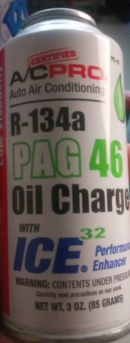

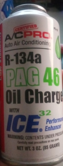

the oil is PAG 46 no sealer added and the
oil pag46
oil pag46

Glad to learn that no sealer was added.
The three-ounce oil charge might be okay depending on how much oil was lost when the HPRV discharged some refrigerant (and oil). But that's pure guesswork. It's always better to have a little too much oil, within reason, than not enough. From what I've read, Ice 32 is relatively benign and should be okay.
