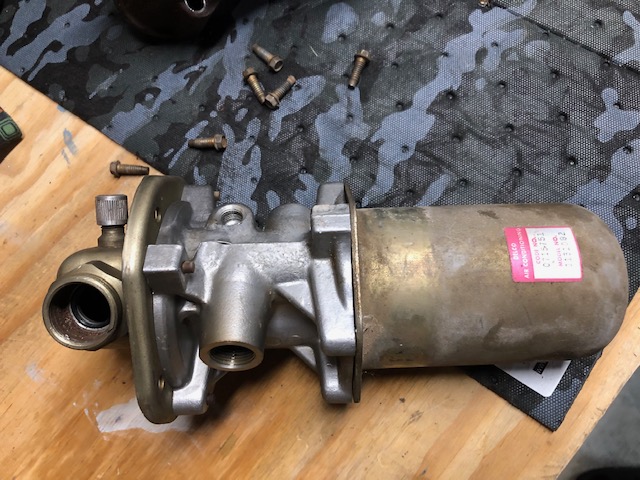

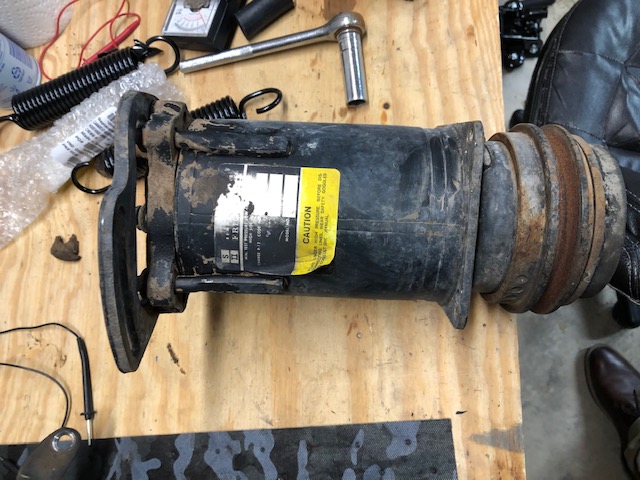

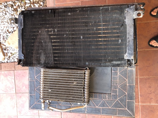

Thanks for the comments, I might be over my head on this, I am not interested in leaving anything original, just looking for the best value without too many headaches. See attached pictures (that is if they are posted). I am pretty mechanical but I don't have much knowledge on auto air conditioning.
Thanks!
Thanks!
- pict6.jpg (142.49 KiB) Viewed 17316 times
- pict4.jpg (135.48 KiB) Viewed 17316 times
- pict1.jpg (108.52 KiB) Viewed 17316 times
Re: Conservative A/C Restore?
VIR with an A6. King of the hill in it's day.

Ok. Best cooling would be keeping the A6, VIR & R12 refrigerant, adding a large parallel flow condenser. Complicated, and not the cheapest route.
Any other choice will also have you fitting an aftermarket condenser. The site sponsor - ACKITS.com has a good selection of aftermarket parallel flow condensers. Tim can help you with that.
Going to 134a and a CCOT conversion has a couple of options.
To start with the accumulator and fittings for the orifice tube should not be terribly expensive. I have seen them under $150 recently.
You will need new hoses for the new condenser, and the conversion. These are not hard to deal with - you will need a local hose shop to help you. You can get the fittings from them, install them & mock up the hose routing & lengths with a piece of plastic tube, a chunk of discarded garden hose etc. Once you have the lengths the hose shop can cut the proper hose from stock, and crimp the ends.
The big choice is the compressor. The A6 is a solid performer, but complicated and not cheap. It has an internal sump, an oil pump, and will basically run all day long. And that is a problem. It was not designed for cycling operation. If your car had an R4 I would stay with it - but your brackets are A6.
Now, anybody that knows me will flinch at this suggestion coming from my keyboard...
Use the aluminum A6 replacement compressor. Yes, it has a little less capacity. I complain about that all the time. BUT, if you use a BIG condenser, and a great fan - it can do the job. Not as well as the VIR / A6 / R12 system did - but it should keep you comfortable.
