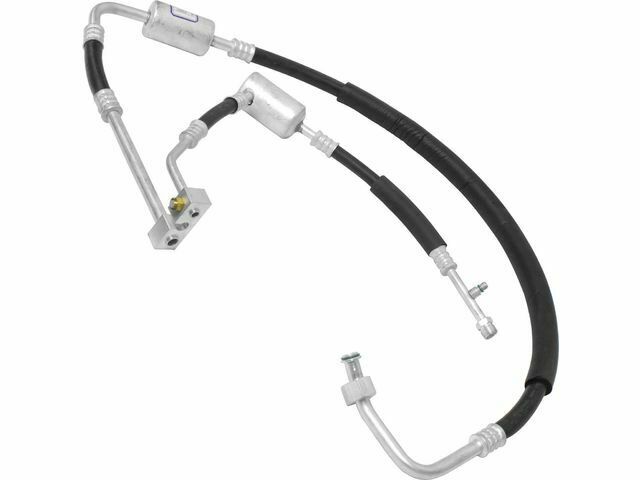

So what are those "cans" on the hose? Filters? I am not necessarily a fan of them, but they were on the hose that fit.

Mufflers? Never would have thunk.
Mine are bigger.

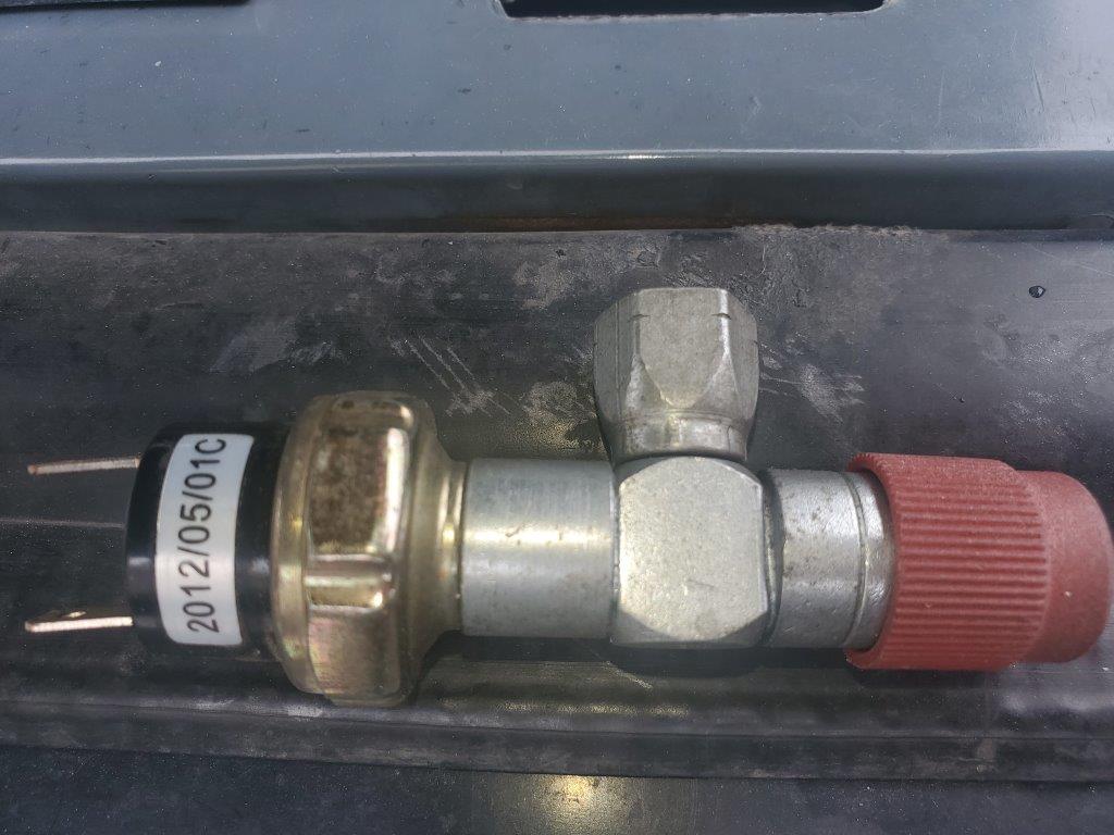

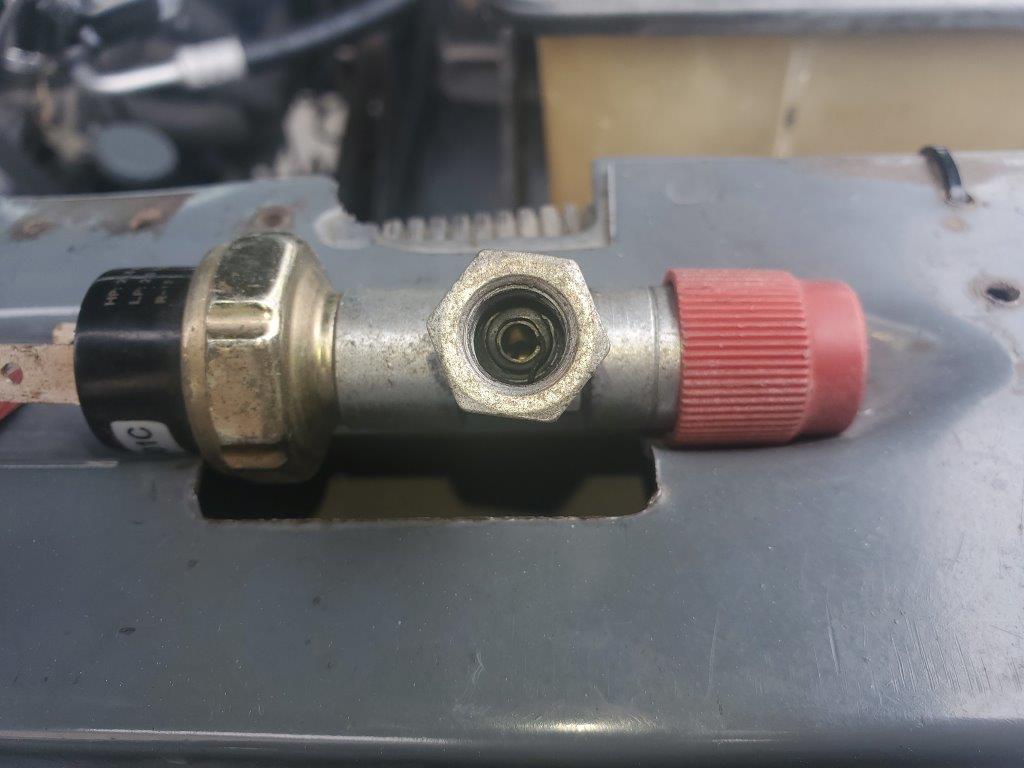

Also have another question. What seal is up in there? Is it an o'ring?
This is the added high pressure cut off switch that was added with the R134 conversion. It installs on the high pressure line port.

Enough with the noise stuff.
Mufflers are a trash trap on a system with a failed compressor. We re-plumb & toss them all the time. On vintage restorations I bore out the tubes in the can, add a straight through tube and braze the can on as a decoration. Plenty of Mopars that way now.

Ok, back to A/C. The seal in that fitting was probably an O ring. I will have to go look and see if I have an unused one to look at and be sure.
If you have a new hose that fits, and has cans in it, no problem. If you are rebuilding hoses, delete them.
