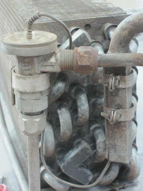

One that I noticed was that all diagrams I see have the TXV inlet at the end and the outlet is at the side. Mine is reversed as it was from the factory. Would that make a difference? See photo. There was no insulation on TXV bulb. Unfortunately, I didn't put any on either.
