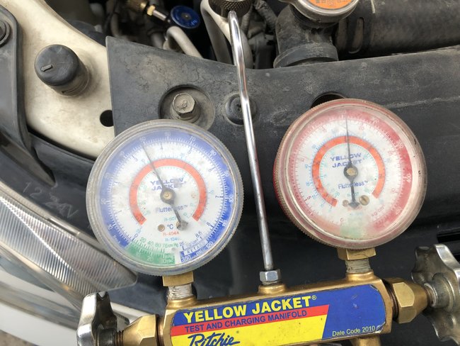

Well i took this pic a while back ago but not 2000 rpm
But yesterday i checked the low pressure at about 2000 to 3000 rpm the low side was 35psi

Updated:
at 2000rpm H was about 125psi
The L was 20 psi
Re: Ac is not getting cold when ilde
Posted: Mon Oct 14, 2019 6:45 am
MacAmb wrote:Updated:
The L was 20 psi
Refrigerant leak. Or refrigerant low to start with after repair.
