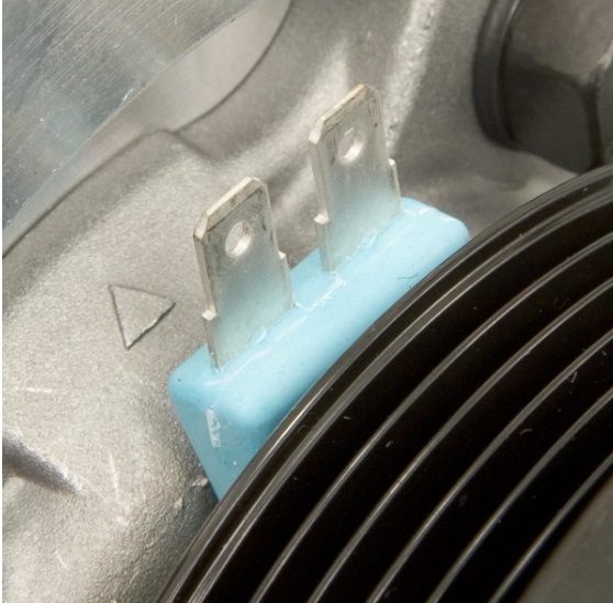

by kenlou
Does anyone know anything about the triangle shaped stamp on the GM R4 compressor body? Does it signify anything, polarity?
