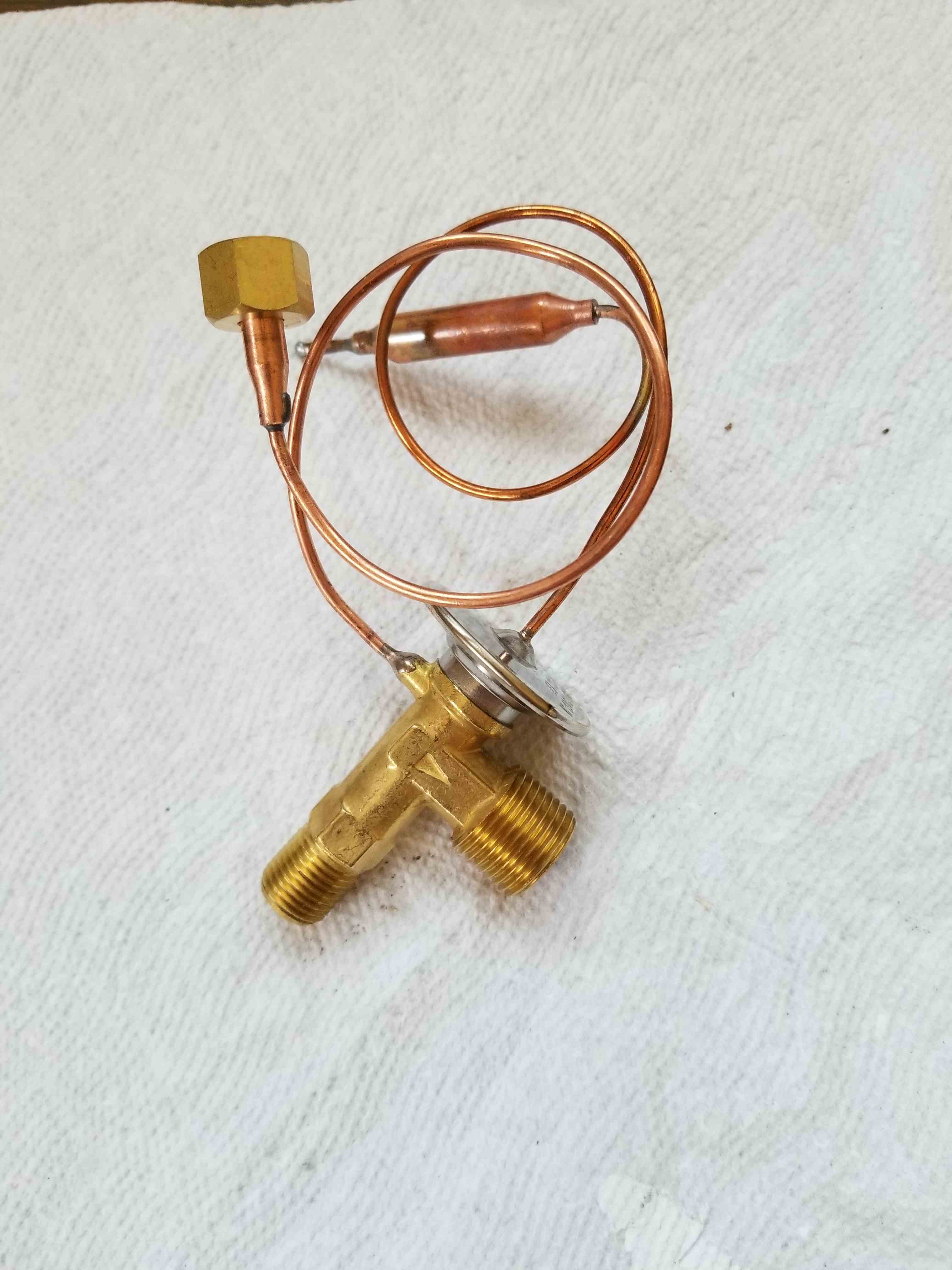

The pictured TXV is one that I have on hand. If yours looks similar, the smaller male threaded end on the brass body (opposite the diaphragm) contains a female Allen-head screw inside that allows adjusting the tension on the superheat spring, which in turn, changes the operating pressures. If you do change the factory setting, ensure that you accurately count and write down the turns or partial turns—and whether you turn the screw CCW or CW—so that you can return to the factory set-point if necessary.

That is in deed the valve. I disassembled the valve I first removed to examine it. I’ll post pics if I can. A seat, a spring and the Allen set screw.
Function:
Bulb Sense Warm - Bulb refrigerant expands and drives diaphragm down, which drives needle down. The needle moves to push the seat down, allowing more flow.
Bulb Sense Cool - The refrigerant liquifies, contracts, and diaphragm raises, raising needle, seat moves up and restricts flow.
Equalization tube, provides a sense pressure to diaphragm.
Spring applies pressure to seat, which is in contact with needle. More preload on spring, means more static force on seat/needle, which in turn then allows the needle and seat to rise (restricting flow) with less signal from sensing bulb. Ie. Less bulb pressure to close needs/ seat.
Reducing spring pressure will require more signal from the sensing bulb (bulb must be colder) to close the seat.
