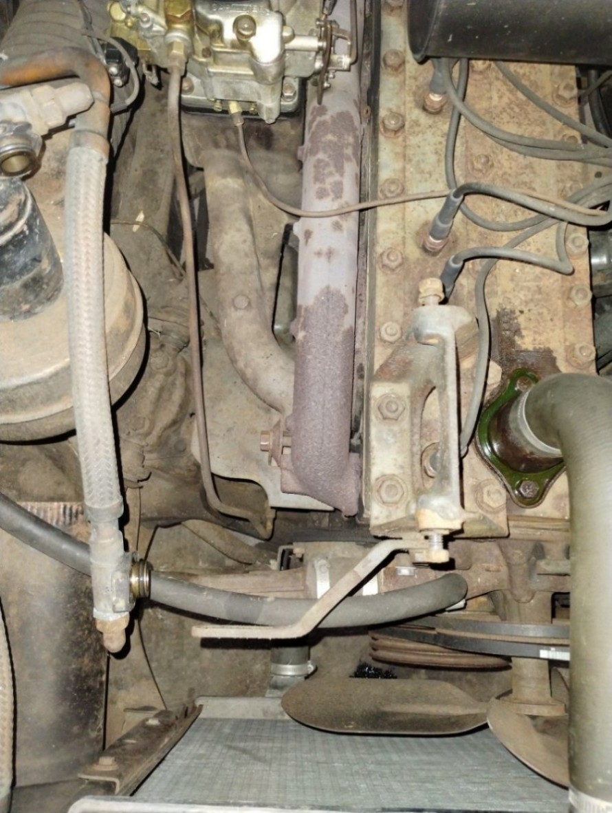

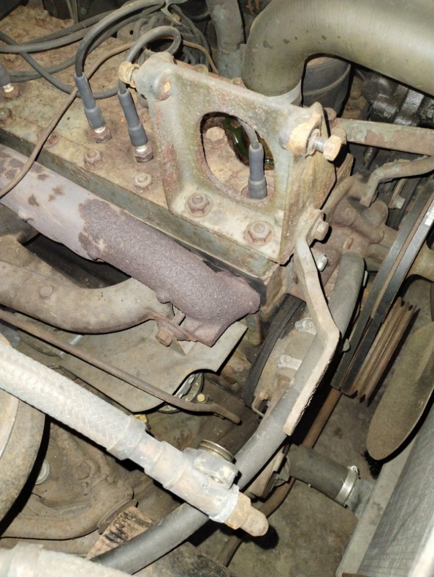

Pics of the original compressor mount.
Earl
Earl

Re: 53 Packard Patrician factory AC
One more
Earl
Earl
