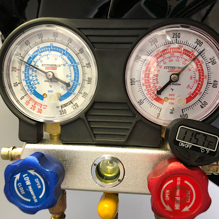

Engine speed revved to 1500-1800 rpms,
All other settings are the same.

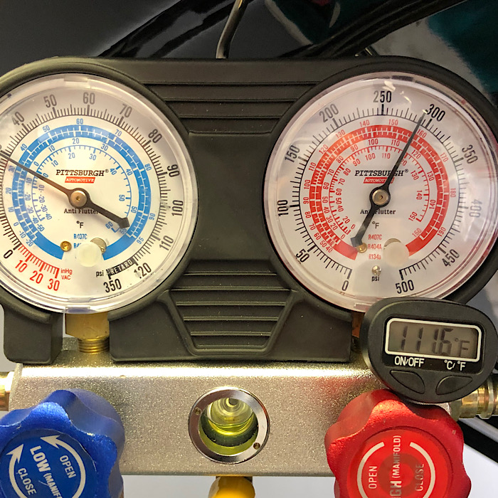

Engine revved to about 2000+ rpms.
- E2335F32-E80F-49B6-BE93-3AB7A088AC9D.jpeg (211.29 KiB) Viewed 10548 times
Re: 1987 Buick Grand National R12 charge
That is the picture with 111* on the thermometer. Pic 2 on this page.

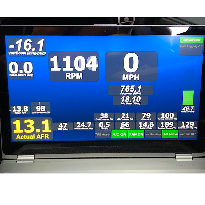

So today while driving, it took about 10 mins to get into the low 50s vent temps. At idle I’d see 49-51* and the compressor stayed on pretty steady. When driving the temps seemed to increase to about 53-57* at 50-60 mph (2000-2200 rpms) and the compressor seemed to cycle on and off a lot. I can see on my laptop when it cycles and it was cycling about every 20-30 seconds when driving at speed. That seemed really excessive to me.
This is how I can tell the compressor is on/off. The laptop shows “AC ON” which means the compressor is on. And it cycles a lot when driving...but at idle it’s pretty steadily staying on.

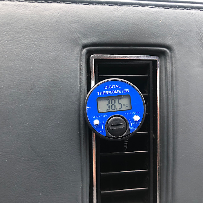

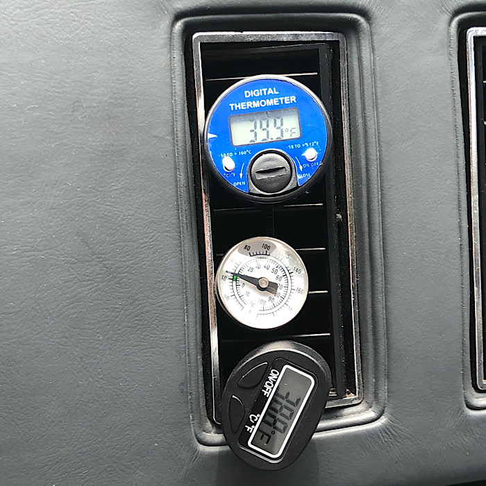

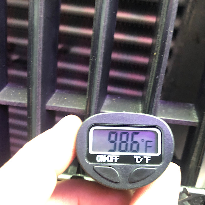

You and he are correct... there is a lot of heat load under the hood.... but it’s the same heat load I had when it used to blow 38* less then 2 years ago...
Here was all of my numbers from 2 years ago when I first charged it.
