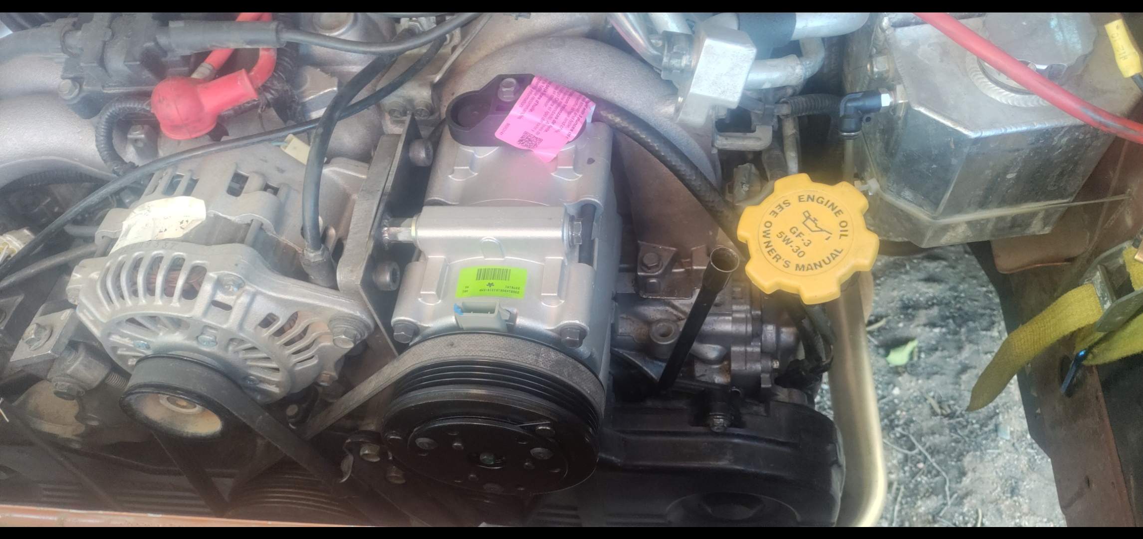

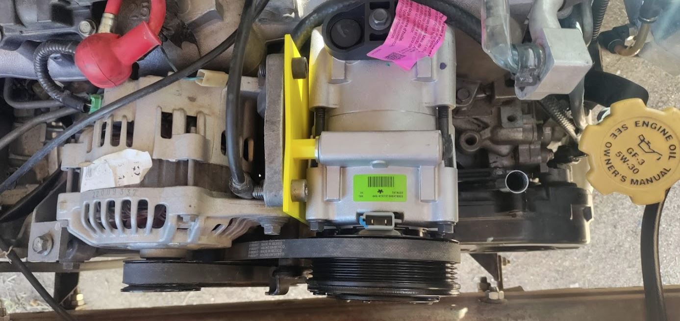

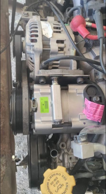

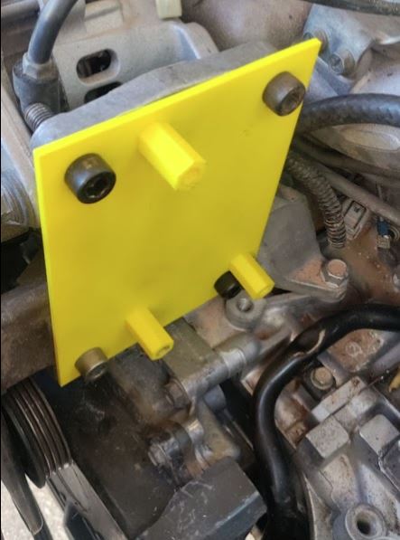

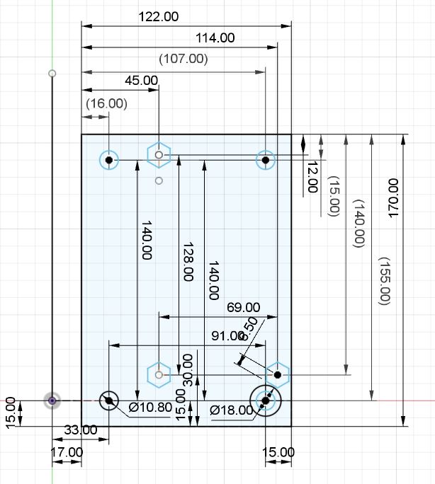

Here are some pics of the adapter place design and install. Still have to make it pretty and it lines up really well.
Measured off the closest belt rib. Had to raise the compressor to clear the bolt for the bottom right OEM hole. 3D printed a sample to confirm clearance. it sagged a little but enough to verify.

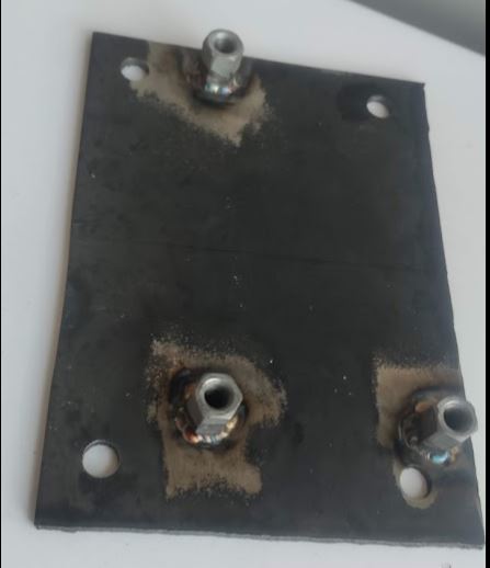

metal version
- metal w-compressor Capture.JPG (63.42 KiB) Viewed 43402 times
- plate steel Capture.JPG (18.97 KiB) Viewed 43402 times
Re: Specs for Compressor - Calsonic 73111FA132 AND discussion on substitutions for Subaru Ej25/22
Some decent welds there

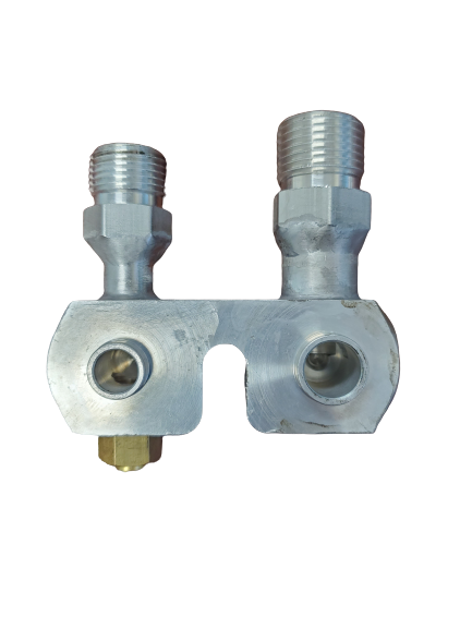

bohica2xo,bohica2xo wrote: Sat Sep 09, 2023 9:18 am
Just run what you have. Re-clocking that compressor leaves a whole new can of worms with the 3rd mounting bolt.
Looks like there is plenty of stuff on that engine right now that is taller than a hose.

*** The main question still is what cans of worms might exist in rotating that compressor 90 deg? The 3rd mounting hole is not an issue and the mount for the 90deg-rotated compressor, I believe, would actually be even better than the mount already crafted.
re: the block you cited -
a couple weeks ago now I've reached out to the manufacturer of the block you included a picture of to get alternate side and front images of that specific block to see how it would fit because
1) it is not clear what the fitting height actually is since it could be like their other offering in the pictures below (in the next post) where the bottom view looks like it could work but the front view makes it clear that the fitting is actually several inches high. (images in next post since this post has reached its limit from your image link and the thread link below)
I've asked the manufacturer for additional views to determine how/if it might work and they do not have any nor do they have any to take since they are out of stock because they make the fittings to order.
BTW, they did say that brass part is a pressure relief valve, I have not yet followed up to ask at what pressure since unless it fits physically it wouldn't matter.
That manufacturer also makes a 45deg one - they don't have a picture of it but I posted a picture from a different manufacturer in this Calsonic thread https://www.autoacforum.com/viewtopic.p ... 817#p27817 Even with the 45deg block it is unclear if the fittings/hoses would be low enough since they would have to overlap on top of each other since they both go to the right.
2) if the block you cited is in fact "flat" there is a concern that the 90deg fittings/hose connectors would clear the front bolt channel and if they would, the fittings should have to be angled over each other creating additional height which, since this adapter plate required the compressor to be raised to clear a mounting bolt. Because of the bolt block behind the pulley I wonder if that specific block is intended for teh FS10s that have the ports on back rather than a top-port FS10 like the one I'm using here.
If the compressor could be mounted rotated 90deg clockwise it would eliminate the height concern plus it would put the hoses in an empty area cleaning up the top of the engine.
