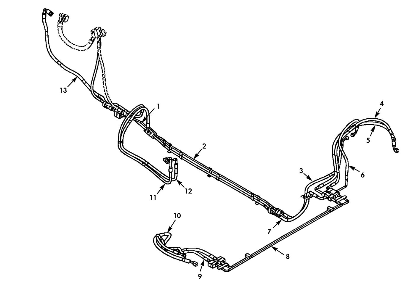

I found the diagram for the OEM AC, I'm not sure why but I would have guessed they would run the condensers in series, but no they are in parallel.
4-5 is the right condenser, 9-10 is the left condenser, that break in the line left of #5 is where the drier goes and 11-12 is the rear evap.
Guess I need to pick up some more Tees, all that plumbing would be outrageously expensive, will probably just do it all in hose, but will check anyway.

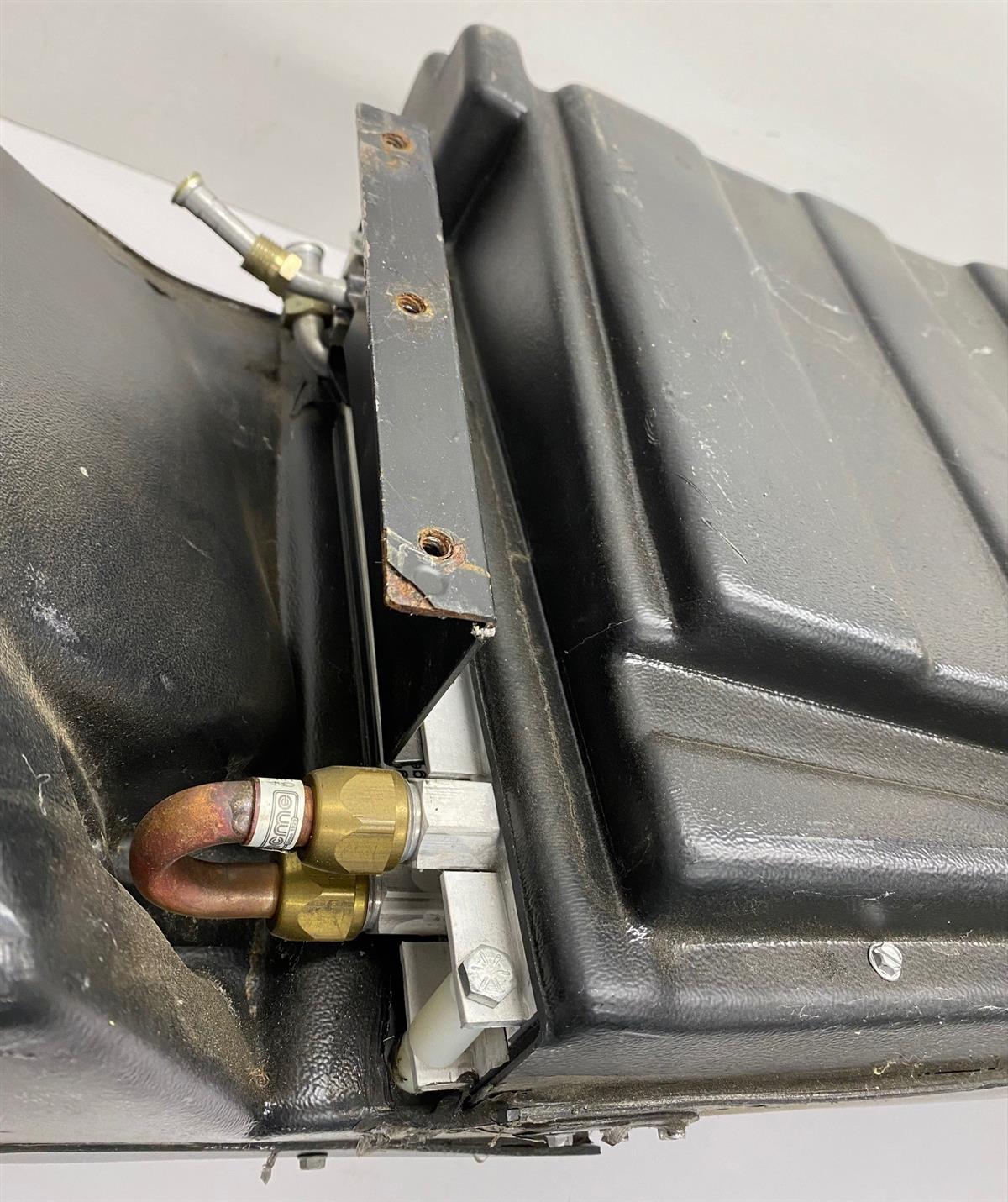

I was thinking series because of this copper loop in the right condenser, I figured they removed this loop to install the dual condenser
