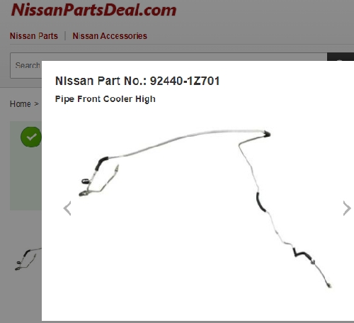

I think I found it. It'a $175 with shipping. I'll call my Nissan dealer tomorrow and see if they will confirm the part number. If so I'll R&R whatever it takes.

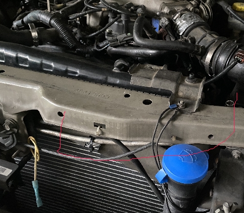

No need to remove the condenser. The line is about 8.5mm OD. I'll stop by Fastenal tomorrow to see if they have the splice. The red line represents what will be replaced. I'll be sure the replacement line isn't stressed in the same place. I'll be chillin soon!

tnfarmboy wrote: Thu Jun 02, 2022 5:41 pm The line is about 8.5mm OD.
Good luck !!!
I'd remeasure, likely that line is 8mm o.d.

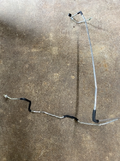

Just in case anyone is interested, I wound up getting the new line and it was actually pretty easy to install. I did a quick test and it seems to be holding pressure, so it's evacuating now.
