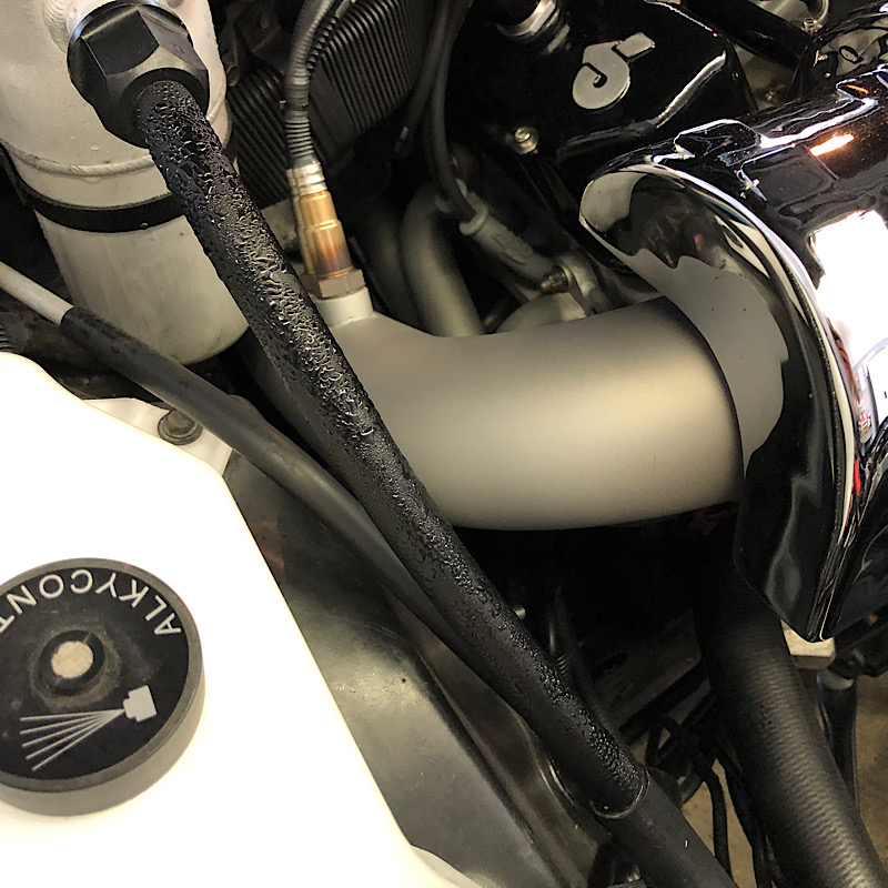

Frosty suction line after 30 min drive.

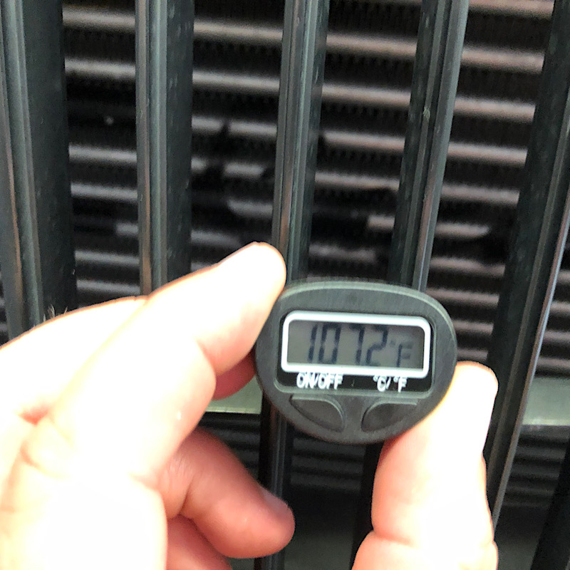

Ambient temp at the radiator. 94* outside but hotter in the garage.

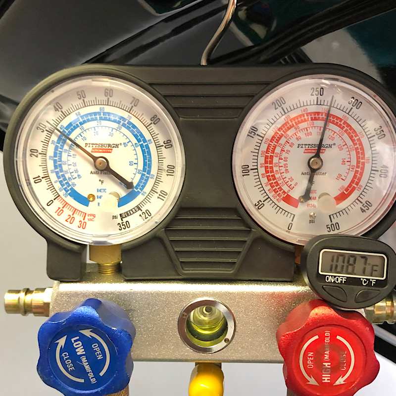

Idle at around 1000 rpms, AC on Max, doors shut, fan speed on 3. Vent temp around 53*.
