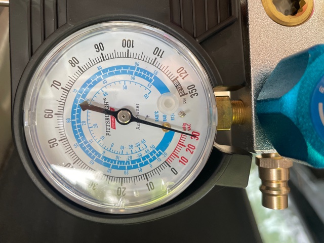

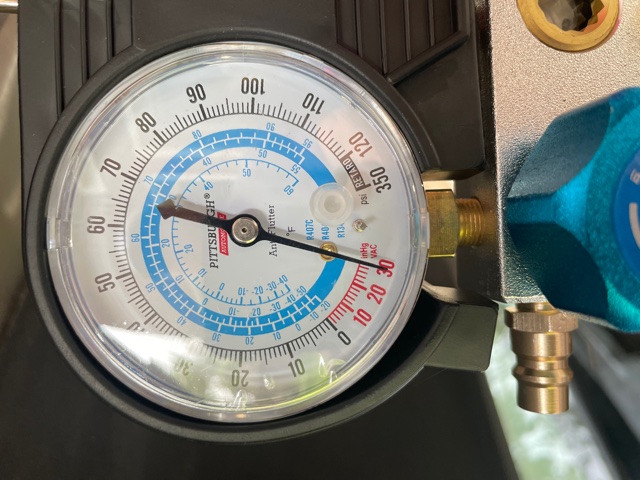

The manifold gauges were a loaner set as well. I took the pump back to AutoZone and got a different one from Oreilly's. Same result. I started looking at the o-rings in the hoses and they were pretty gnarly. I ended up picking up a brand new set of gauges. Full disclosure, they are the Harbor Freight set. I hooked up the pump to the new gauges and it vacuumed down to 26 Hg within a minute or so. It wont vacuum down below 26 Hg, but it has only been a few minutes.
Can I assume there are no leaks in the system since it held vacuum overnight? The vacuum actually increased overnight to 20 Hg. I don't understand that (ambient temp?). I'm going to let the pump run for a while to see if it will vacuum down any lower. I'm kind of at a loss here.

jtupper wrote: Sun May 22, 2022 12:08 pm The manifold gauges were a loaner set as well. I took the pump back to AutoZone and got a different one from Oreilly's. Same result. I started looking at the o-rings in the hoses and they were pretty gnarly. I ended up picking up a brand new set of gauges. Full disclosure, they are the Harbor Freight set. I hooked up the pump to the new gauges and it vacuumed down to 26 Hg within a minute or so. It wont vacuum down below 26 Hg, but it has only been a few minutes.
Well, 26 InHg is better than last time but still inadequate. Since you have a new Manifold Gauge Set connected, that would seem to rule out leakage at the knurled hose ends and the MGS itself. It must still be a weak vacuum pump since the system itself maintains the maximum pump vacuum over time. Try running the VP for about one hour and see whether the vacuum reading drops. If not, I would suspect either the oil again or an abused VP that just will no longer pull an acceptable vacuum.
jtupper wrote: Sun May 22, 2022 12:08 pm Can I assume there are no leaks in the system since it held vacuum overnight? The vacuum actually increased overnight to 20 Hg. I don't understand that (ambient temp?). I'm going to let the pump run for a while to see if it will vacuum down any lower. I'm kind of at a loss here. BTW...I'm in Houston so I'm at or just above sea level.
Typo? I think you must have meant 28 InHg and not 20 InHg. I can't explain why the reading would increase slightly overnight.
Sometimes, a system can hold vacuum indefinitely but leak under pressure, and vice-versa. So because it held vacuum overnight is no assurance that it won't leak after charging.
Since you're virtually at sea level, you should see a vacuum of 29.9 InHg or better. But you would need a micron gauge to measure a lower vacuum reading (in microns) because at that reading, you'll be at the practical lower limit of your low-side gauge. For your purposes, 29.9 InHg should suffice, though.

Yes, I meant 20 inHg. Apologies.
After letting the pump run for about 1.5 hrs, it pulled down to 28 inHg. I was going to pull the gauges off and double check that it is zero'd properly, my low side port is now leaking. This is so incredibly frustrating. Now I'm off the get a new port or schraeder valve.

And we have liftoff...
Low and high port schraeder valves replaced, fresh oil in the pump and back under vacuum. Went to 28 inHg almost immediately. I actually tapped on the gauge a couple of times and it went to 30 inHG. The plan is to let it vacuum for an hour or so, then let it sit for a couple of hours to ensure it stays under vacuum, the charge with refrigerant. Sound about right?

Yes, sounds about right, good job.
Be careful when you switch your yellow hose from vac to charge that you do not introduce any air!!
Be sure you bleed all your hoses of air.
You are probably using cans even tho that is not the preferred way.
For the first can, turn it upside down and thus rapidly charge liquid into the high side (COMP OFF)with the blue side valved off. This gets a lot of refrigerant in right away so that the comp doesn't start up with a measly charge, because such a charge will carry very little oil, and that is not good for the comp. Then you shut the red side handwheel, and charge the rest of the way with vapor (can upside right) into the blue side with engine running, comp on.
Once you are done charging be sure you have both handwheels closed in order to take pressures. With the comp running, you never want the high side handwheel open.
Once all charging is done, shut the quick coupler to the high side on the car. You now have a red hose with high pressure liquid trapped, and a blue hose with vapor. Now open the red handwheel and allow the high pressure liquid left in the red hose to bleed back into the car. Then you can shut the blue coupler, and remove the hoses entirely.
Read this over several times to get your head around it.
When charging vapor you will likely need to have a warm water bath handy because the can will get very cold and as such will not deliver the full can contents.
Report back with ambient, center vent temp at 1500 RPM, doors open,recirc on, max fan, mac cool, and high and low pressures.
