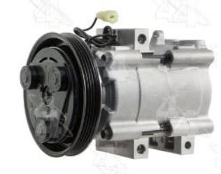

bohica2xo wrote: Sun Aug 27, 2023 5:57 am Your space constraints mean you need a specific pattern of FS10. Some models have ports on one side, instead of the rear. This gives you a place to mount a manifold on "top" of the compressor with it installed on your engine with the mounting bolts horizontal. There are various manifolds available to direct the suction and discharge towards the passenger side of your engine, or the rear of the vehicle if you like.
I spent some time on the 4S site since I could search by FS10 and they have pictures and good details like pulley dia. And its good to know that ACKits.com can get pretty much anything.
There are several with connections on top left-right like the one you linked previously https://www.ackits.com/2005/ford-113583 ... clock-3651 including ones with 4-rib pulleys like the Four Seasons 68143
4s 68143 4-rib.JPG (18.22 KiB) Viewed 41597 times

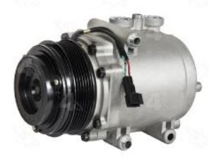

There is also just one version of where the connectors are forward/back the Four Seasons 178588 and it has the pulley closer to the compressor which may help alignment. The benefit of the forward/back connections is that it may allow for easier to have both pipes going to one side of the compressor. The left/right version above may have to overlap
4s 178588 f-r.JPG (16.67 KiB) Viewed 41597 times

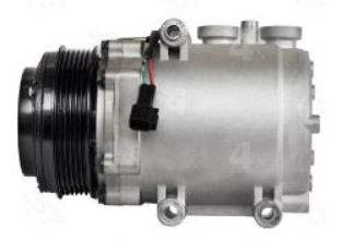

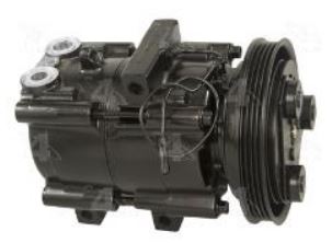

For reference these are the FS10 compressors i found on 4S (looking at pictures) with top connectors. There may be some I missed.
4s 178588 f-r side view.JPG (15.95 KiB) Viewed 41578 times
--Fittings front/rear (this is the only one I found like that)
4s 68143 4-rib side view.JPG (16.96 KiB) Viewed 41578 times
--Fitting left-right

Re: Specs for Compressor - Calsonic 73111FA132 AND discussion on substitutions for Subaru Ej25/22
Try not to over analyze this by looking at every known compressor.
The FS10 is one of the few with enough volume to run a large evaporator like you want.
I have noticed over the years that 4 rib pulleys tent to be larger diameters. Many times this was because they were mounted on small displacement engines that either revved very high or were in smaller cars that did not need so much refrigerant flow. No real need to run a 4 rib pulley specifically, the 4 rib belt will stay in place just fine on a wider pulley.
Your speed calculations point at pulleys under 130mm for good low speed performance.
Whatever that 178588 thing is, it is not an FS10.
