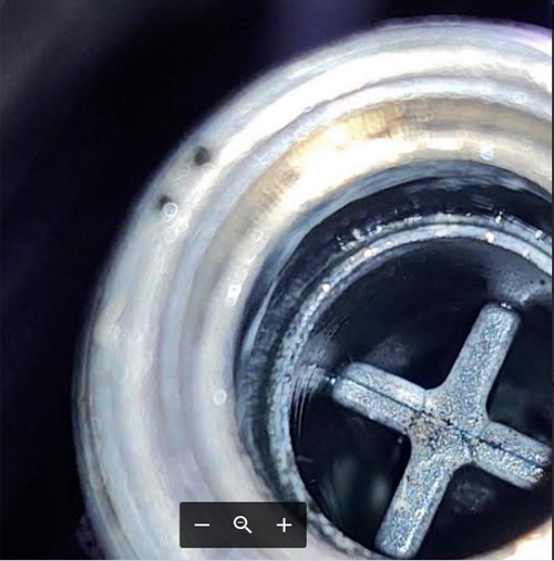

@GMTech, thank you; there was an OT in the condenser output.
Is that OT, combined with the other OT and TXV enough to raise the head pressure to shut off compressor?
I inspected the OT in the condenser and other than oil, it's clean. This makes me wonder if what I thought was shmootz on the required OT was also just oil (my eyes aren't so great and when it's really hot, my glasses tend to slide off my face from the sweat).

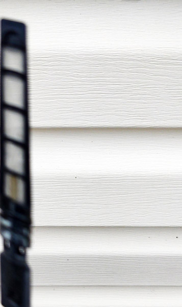

Though a little blurry, the OT appears to be OK. With the other OT removed, do you think the system will operate correctly now? In other words, do you think two OT's and a TXV were enough to cause the high head pressure?

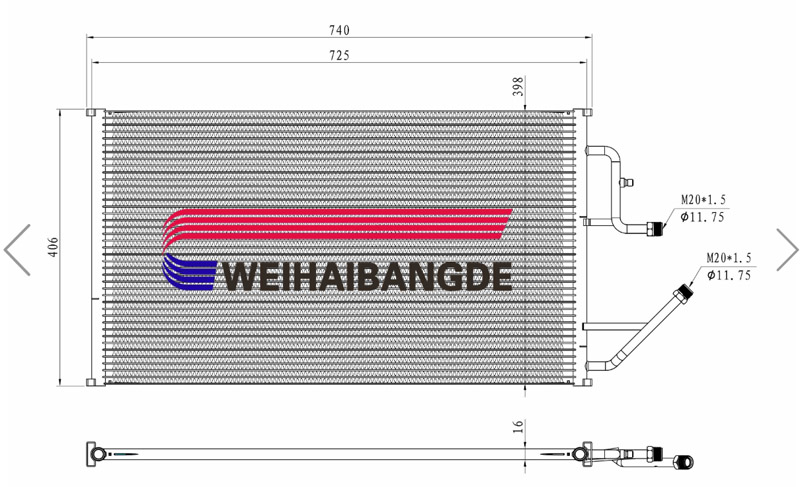

This is why we have many experts like GM Tech. I would get it back together with a single (condenser) OT and the rear valve and see what happens.
Looking at this image, it reminded me of what he mentioned. Had this happened in the shop way back when!
