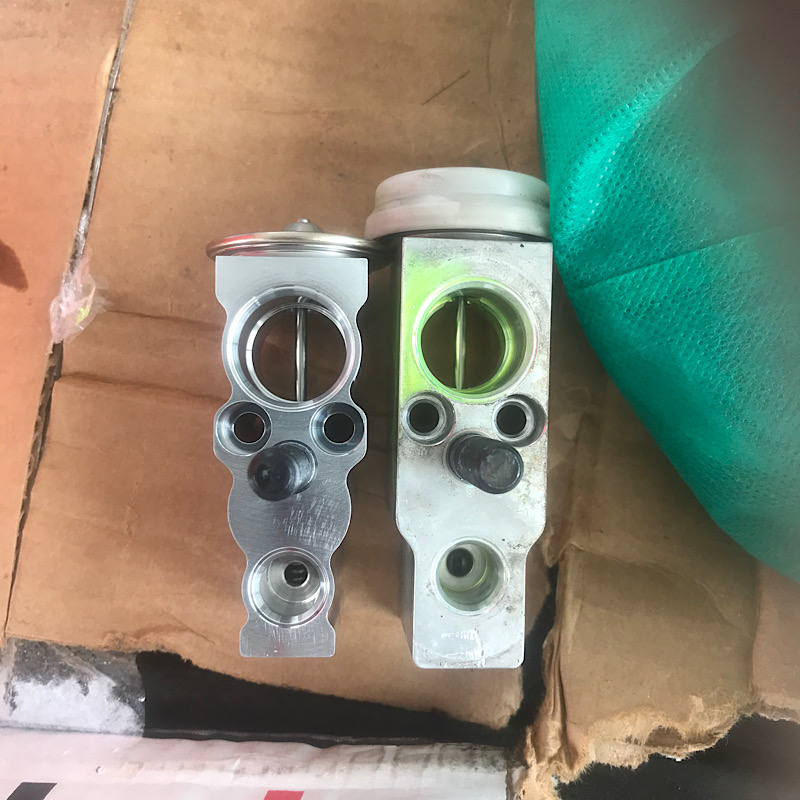

Ford parts advisor said that the TX valve has been upgraded.
My question is:
Based off the look of the new TX valve on the left & the old one on the right, what purpose does the redesign offer?
I see thinner walls which probably help with heat transfer?
Also less material used therefore reducing the price of the part?
Would like to hear your thoughts.

"Ford parts advisor said that the TX valve has been upgraded."
To me, that is dealerspeak for 'cheapened'
I seriously doubt there is any difference in performance. The heat transfer that we need in AC work occurs at the evap, not the TXV
The walls where the pipes engage look dangerously thin and probably could crack way more easily, especially given the temperature cycling that occurs there. If I had a choice, I would pick the old style

The bean counters have "re-engineered" that TXV, all right. The only difference that I can see comparing the new versus old part (discounting the thinner walls) is the slightly smaller HP orifice on the new TXV. What difference that makes, if any, I can't even hazard a guess.

Agree, left valve is lower cost, less aluminum, eliminated dome insulation. These things happen over the lifespan of a vehicle model. The suppliers agree in advance to a certain level of cost reductions year over year. I doubt there is any noticeable performance difference
