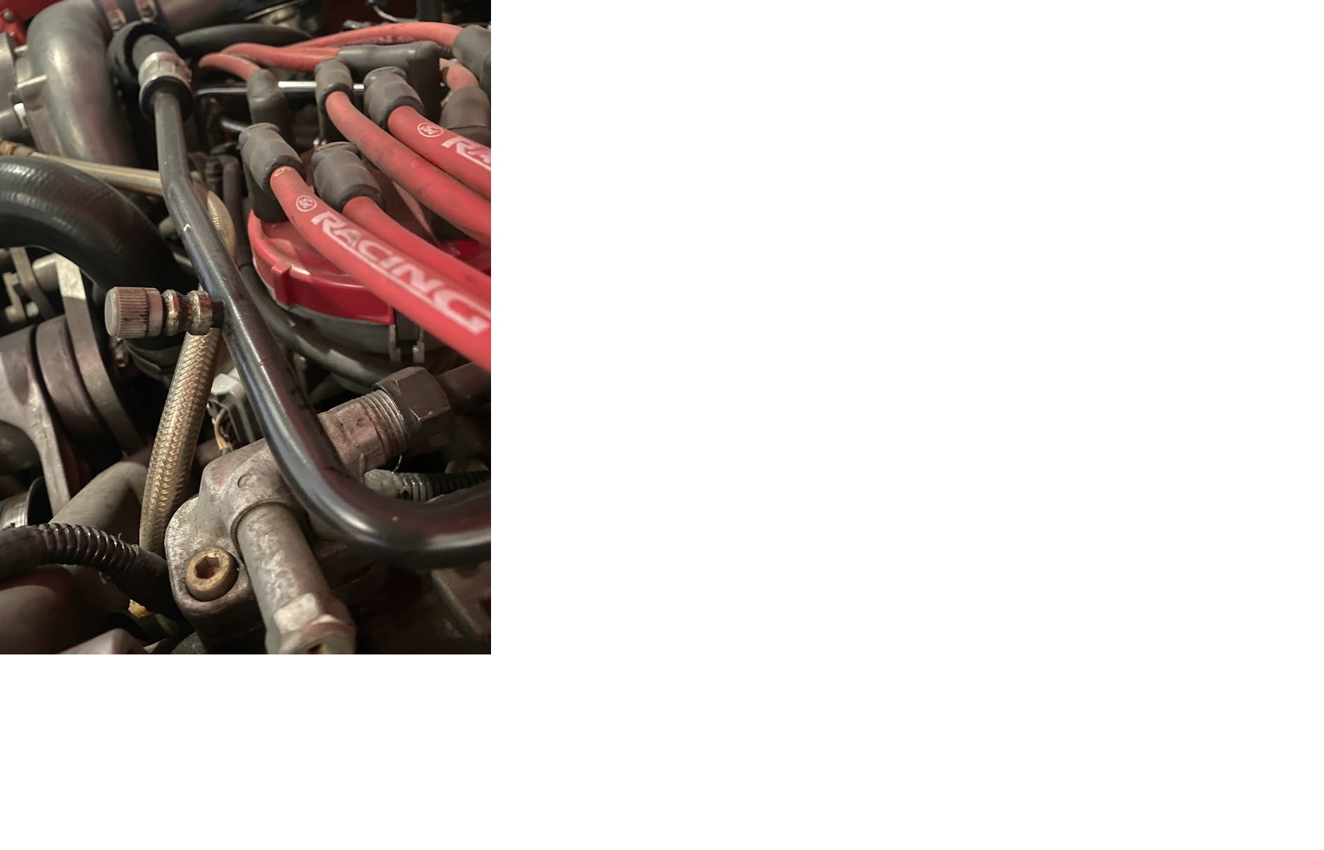

Why wouldn’t the hot swap idea work? I’m looking for a Hail Mary here with that high side charge port.
I took a pic of the high side port was...didn't realize how dirty it was. It doesn't look much better underneath the compressor.
- high side port.jpg (195.99 KiB) Viewed 14282 times
Re: 1991 Mustang GT w/ R12 - need help
Please re-read what I wrote

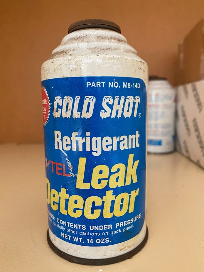

Looking through my stash of R12, I found a can of leak detector. Any issue with using this stuff?
- IMG_7413.jpg (131.84 KiB) Viewed 14103 times
Are you certain that is R12? I am not familiar with the name Cold Shot.
I am pretty sure that dye is the red colored dye tho, and I am not sure how well it shows up. They went to the yellow-green luminescent dye long ago.
But you have a TIFF sniffer! The sniffers trump the dye any day of the week!
