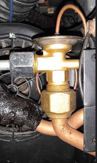

Tim wrote: Mon Jul 25, 2022 7:45 pm Thanks for contacting us. I'm going to need an image of the TXV valve. It could be a standard universal. But an old under-dash system like that might have something different.
R12 is harder to find these days. I may be able to find a cheaper Drier. Is this the type of drier you are looking for?
37-13732-AM
Yes - that is the style of dryer I need. I like that it has a service port. My existing dryer has a port for the pressure switch on it. If pressure switch port is not available on the dryer, is there an inline fitting I can place immediately after the dryer to mount the switch (fitting length would be limited to 2 inches)?
Expansion valve image attached. Looks to me to be same/similar to 4 Seasons P/N38608.

As long as it is an O-ring valve.

As long as it is an O-ring valve. I have no idea if the valve connections are flare or o-ring. I think I may have a spare evaporator core squirreled away in my spares but will not get to access that for several days. If I have a spare evaporator, it would tell me the connection configuration.

The expansion valve has flair fittings.
