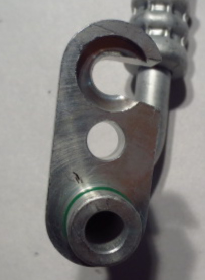

Tim wrote: Wed Jun 01, 2022 7:11 pm Is he looking for a discharge line? I had comp to evap.
Discharge Line 3.3L
57-0246
Yes, he is looking for a discharge line for his V6 VG33 2004 Frontier. Notice that 57-0246 does have the notch at the condenser fittin

Like this? LOL
Re: Leak
Posted: Wed Jun 01, 2022 7:52 pm
Tim wrote: Wed Jun 01, 2022 7:45 pm Like this? LOL
Like that !!!
And it looks - to me - like the 2004 Frontier uses same condenser whether 2.4 L4 engine or 3.3 V6 engine. So the horizontal line that runs over top of the condenser doesn't need to be monkeyed with, slides through the notch in the high pressure line.

The call for a different item number on the 2.4Ln Both have a notch in them.
