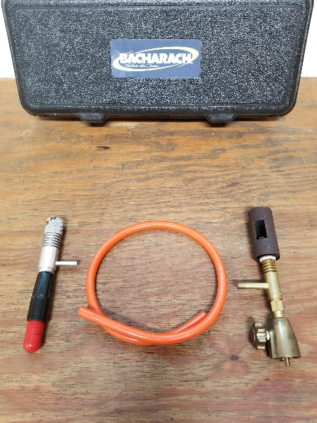

I added these two halide torches to my toolbox, circa the mid-1960's, when R-12 was in its heyday. I tried not to inhale too much while using them, though
I purchased the electronic sniffer, inside the case, later on.
