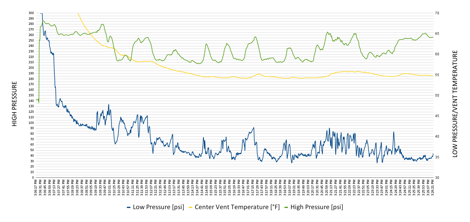

Lexus AC datalog.png (128.07 KiB) Viewed 16490 times
Collected data on the way home today.
1999 Lexus LS400 - 108 deg F Ambient - Start from heatsoaked (interior temp 160deg F)- Windows open blower speed max recirc heater hoses pinched
First 3 mins: 1500 RPM stationary
middle: City driving, stoplights etc.
Last 2 minutes: 1500 RPM stationary
Keep in mind the left vertical axis is for high press only, right axis for low press/vent temp. Heater hoses were pinched off for good measure.
Towards the end I got out and felt the suction line exiting the firewall, it was cool but barely, if I had to guess, 60-70 degrees F. The entire datalog is with the windows open and 108 degrees outside, so yeah it was a hot drive home. Normally with the windows closed the vent temp will come down into the 40's after about 10-15 minutes.
The system was just evacuated and recharged with 24oz of R134a about a week ago. Everywhere the high side is peaking was when I came to a stoplight/was idling. You will have to ignore the noise on the low side reading I don't know why it was jumping around so much. The pressure sensors are sensitive to heat so they don't do super well in the engine bay. It would probably also make more sense to stretch this out width wise more because its a 20 minute log of data scrunched into a small chart.
Here is a link to the raw data if you so desire to look at it.
https://docs.google.com/spreadsheets/d/ ... ue&sd=true
The low side pressure port is between the evap and the EPR valve

I was hoping we could get similar data with the windows up and blower on recirc, so we could see what is happening to the cabin, not while trying to cool the environment down
I myself would like to compare lo side pressure to vent temp
3 data points would be nice, 5 min, 10, and 15 min.
Yes the heater hoses are clamped but I have done that and it is hard to clamp them fully tight and I have been misled.....
I also still think your TXV is under performing

Very interesting data chart and I applaud you - really, I do. My data about vent temperatures comes from my sweaty forehead and a meat thermometer stuck into the center dashboard vent. Sorry, no logged pressures. A few weeks ago here in sweaty Louisiana and after reading a few things around here, I decided to mist the condenser in my El Camino with a little water to see if my sweaty forehead and forearm could tell any difference.
Well, it did make a difference of maybe 2-3 degrees on the meat thermometer and my skin. This told me that my system performance is probably constrained at the point of shedding heat at the condenser and a pusher fan in front of the condenser might help.
In went a seven inch pusher fan that consumes about 80 watts of electricity. I can now dependably reach a 35 degree vent temperature which is a five degree improvement.
Maybe your vehicle could use a pusher fan????

Nice looking data that shows bad looking things :D
I think your TXV might be having a problem, or maybe you have a clogged filter upstream of the TXV, or something else, because I still don't understand exactly what this car uses for an expansion device, you've mentioned a pressure regulator. Your evaporator superheat looks too high to me, but I don't know how much suction line superheat this is designed to produce with the integrated IHX in the evap core.
Is your liquid line medium-hot from condenser out to the firewall?
