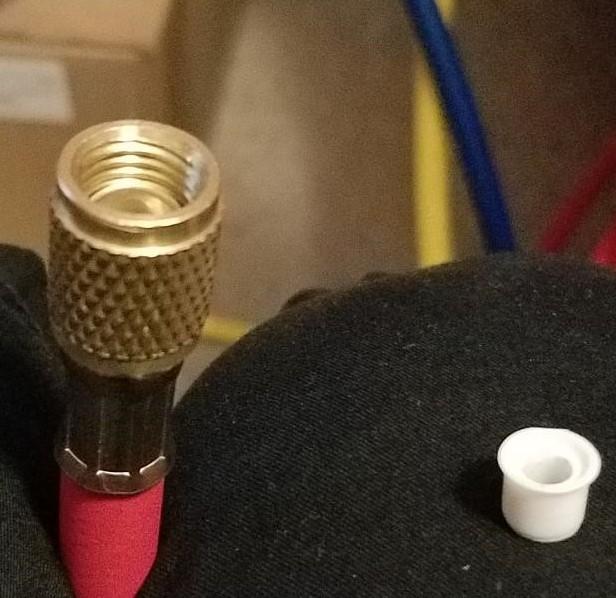

gauges leak out freon after use

Can't really tell if that is acme but i do not think so. Seems to be the usual 1/4"
Do not see any evidence of the seal
- Posts: 1848
Re: gauges leak out freon after use
The white object to the right...is THAT the seal that came out of the hose-end connector? If so, I never saw anything like it.
Agree. I posted a pic of what the seals are supposed to look like.
John, maybe he bought the manifold and hose set on April Fool's day
