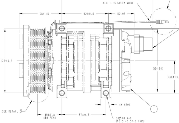

These TM21 can be purchased with the block fitting. Which one would work, vertical or horizontal?
Re: 2008 Suburban vs 2000 Excursion AC Functionality
Posted: Tue Jun 29, 2021 12:03 pm
This might help.

It appears he is referring to this monster:
The QP25
http://firewall.reddotcorp.com/pdf/QP25 ... ochure.pdf
Tim,
Can you get red dot parts? I thought I saw some on your site.
Here is the red dot part number 75R91182Q
It is a 141 mm clutch would the extra displacement make it worth it? Is this too much compressor? Would I need bigger lines from stock?
It looks like the rear connections will work with the stock hoses. I think I will have to build an adapter plate to move it forward a bit to get the clutch lined up as it’s shorter from the front mounting holes to the middle rib of the pulley.
