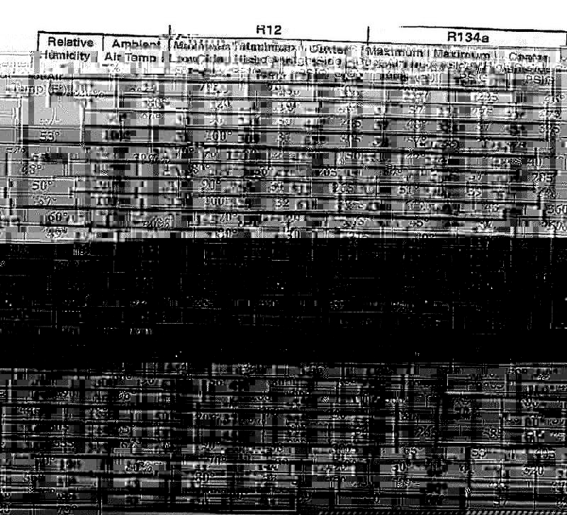

PS: I just found this chart (hope it posts). It is relative humidity temperature service port pressure chart.
Interpolating it we should find a little different than I expected:
45-50 low side, 365/380 high side at 86 degrees 66% humidity. I feel better, however something is still not right.
What now?
