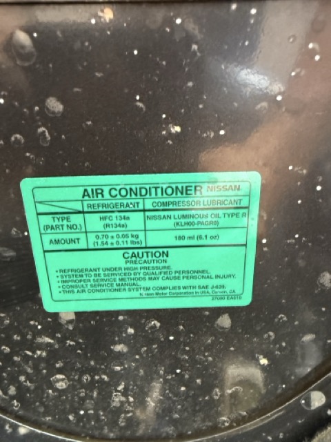

Seems to be cycling pretty quickly. 1.5 Lbs is the correct refrigerant; what's the sticker on the radiator support say.
Re: 2019 Nissan Frontier AC troubleshooting (Video link attached)
Posted: Tue Aug 11, 2026 11:27 am
by mcFish
Yes, correct

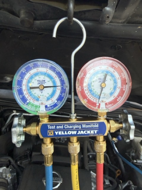

Ok, my last test for today!
Ambient temp 99F. Static 100 psi.
Garden hose: High side is dropped to 150F, low side jumps 40-70 as compressor On/Off.
Low side pipe temperature is not changing, barely cold, same as air vent temp!
- IMG_2939 Medium.jpeg (90.59 KiB) Viewed 17115 times
Garden hose at the beginning:
https://youtube.com/shorts/hu_M75rv3_g?feature=share
At the end:
https://youtube.com/shorts/_tnh5z9CVkE?feature=share
