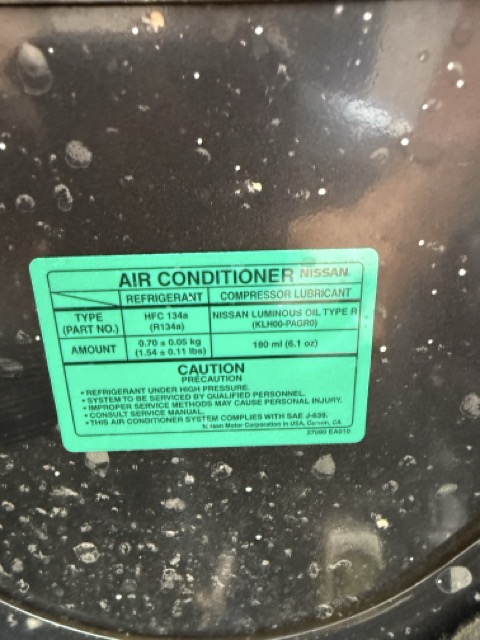

Seems to be cycling pretty quickly. 1.5 Lbs is the correct refrigerant; what's the sticker on the radiator support say.

Yes, correct

I've got to get back to some corporate stuff. Check that the heater core is not allowing hot water into the core when in a/c mode. As in the other post. Have you overloaded the oil capacity?

I didn't evacuate/refill oil. And I assume yellow dye is OEM Nissan Luminous oil.

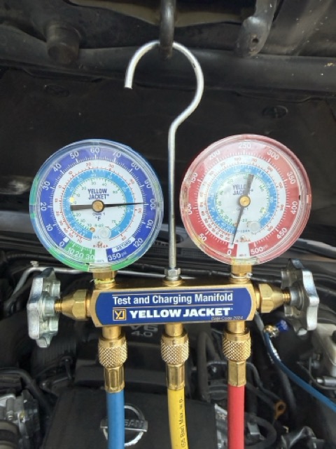

Ambient temp 99F. Static 100 psi.
Garden hose: High side is dropped to 150F, low side jumps 40-70 as compressor On/Off.
Low side pipe temperature is not changing, barely cold, same as air vent temp!
