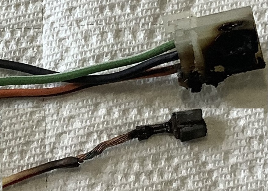

Between the rain and the heat, I was able to get a little more done in this quest. For quite some time, my blower motor only ran on high, so I decided to get that fixed before anything else. The resistor was toast….so rusty and crusty. The electrical plug was burnt and partially melted also. I went ahead and got a new pigtail and resistor and also replaced the blower motor,

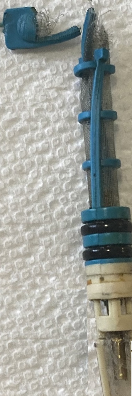

The orifice tube was a bear to get out, I actually broke it (it is really clean, hardly even any oil on it)

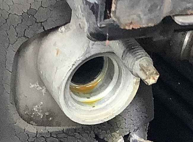

Well, I managed to get the compressor out of the truck. The induction heater did not work for me. With the limited space I had to work with, I ended up using an oscillating saw to cut the bolts. I can’t believe the amount of rust I have had to contend with on this project. The long needle nose vice grips worked on getting the studs out of the block.
I had to remove the fan and radiator shroud to get the compressor out from the top side.
