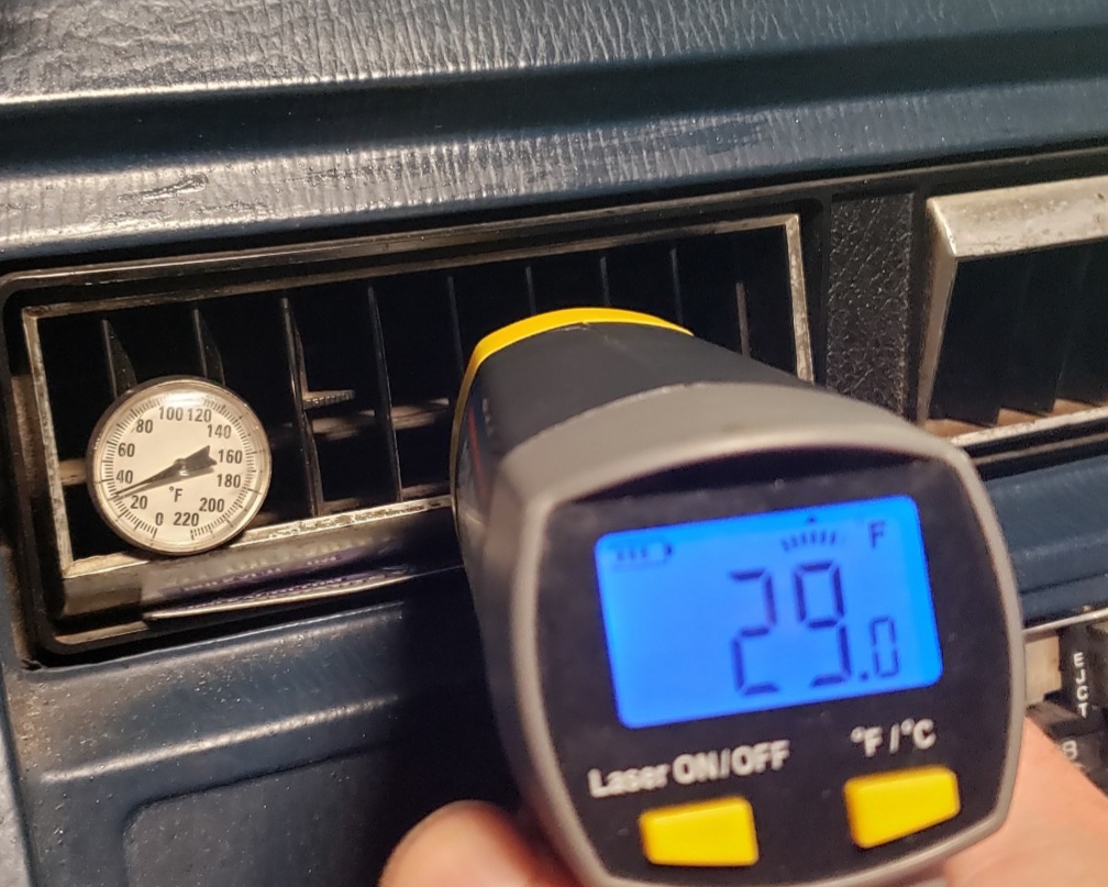

It is not crazy hot here yet, but I was driving around the 1987 G20 today in ~100F and about ~45% relative humdity. It was muggy and hot feeling. I brought out my thermometer and hygrometer and measured the ambient air conditions as the readings above. Brought the engine up to 2,000 rpm per the GM performance test detailed in the FSM and center vent temps dropped to around 30F before the compressor cycled even with high blower speed selected. I knocked off the recirculate function, warmed up to 42F and held steady there. It is cooling fantastically well. So much for the theory you have to run R12 to have ice cold air in the R12 era vehicles.
