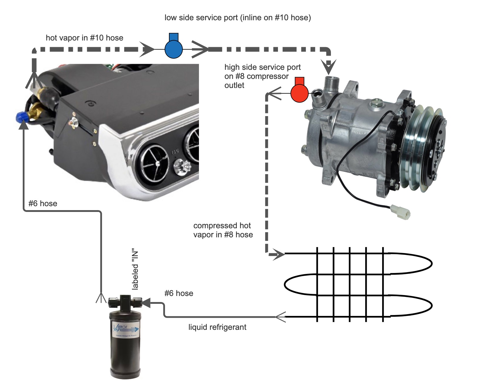

I had a sinking feeling that I was going to be pulling my radiator out and fabricating new hoses. Fortunately, I checked the car again and it is my diagram that was wrong, not my install!JohnHere wrote: Tue Jul 02, 2024 8:22 am In your diagram, the condenser is inverted.
High-pressure refrigerant gas from the compressor enters at the TOP of the condenser, condenses, and travels to the outlet at the BOTTOM, exiting as a high-pressure liquid. The liquid refrigerant then flows from the bottom of the condenser to the R/D and on to the TXV, where it changes from a high-pressure liquid to a low-pressure liquid.
The low-pressure refrigerant gas (and sometimes a mixture of gas and liquid on systems having an OT and accumulator) exiting the evaporator is normally cool to cold.

- AC diagram.jpg (244.56 KiB) Viewed 9239 times

That's better.
Glad the installation was correct and just the diagram was wrong.

Nothing hisses out when I do this test. And the gauge on the high side pegged below zero when I ran the vacuum pump. Looking in the direction of flow, there is a lot in the way that could be blocked. But looking backwards there is just the expansion valve. So If I loosen the #6 connection to the expansion valve and nothing comes out then the problem is the expansion valve, right?JohnHere wrote: Tue Jul 02, 2024 6:11 pm Try this: Momentarily depress the stem of the Schrader valve in the high-side service port with a small screwdriver or other suitable tool and see whether anything hisses out. If so, something is wrong with the connection of the MGS to the service port, the Schrader valve itself is bad, or the high-side gauge is defective.

We now have concrete evidence that your MGS on both the HS and LS are accessing the system and that the HS gauge isn't faulty.msrichmond wrote: Wed Jul 03, 2024 7:40 am Nothing hisses out when I do this test. And the gauge on the high side pegged below zero when I ran the vacuum pump.
I've dealt with a problem like this before, but I've never seen one side of the system completely obstructed like this. We've exhausted all other possibilities except for the HS being blocked someplace.
Right...you're getting refrigerant into the LS through the MGS LS service-port connection and building pressure in the LS, but you're getting neither refrigerant nor pressure into the HS based on your "zero" pressure reading on the HS. I'm guessing that refrigerant can't flow backwards through the TXV (although I've never experimented with this scenario). The next potential stoppage point is primarily the compressor, followed secondarily by the condenser, R/D, and TXV.msrichmond wrote: Wed Jul 03, 2024 7:40 am Looking in the direction of flow, there is a lot in the way that could be blocked.
If, as the diagram shows, your HS service port is right after the compressor's outlet connection, then by default, something inside the compressor must be stopping any pressure from building in the HS, possibly a reed valve being stuck shut, or something else.
