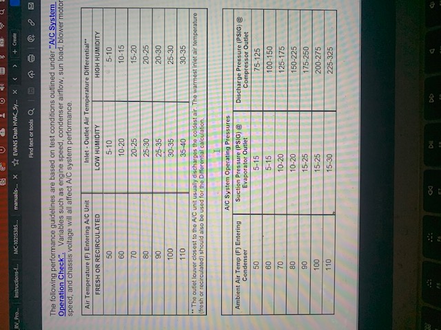

Here is a page from the Evans Tempcon RV manual for Front Occupants HVAC Service Manual. Pressures are listed as PSIG???

Your latest test @1800 rpm showed 14psi low and 210 high side. 95f ambient, and a vent of 60f With 40% humidity
So if we look at the chart provided by Evans
At 90f intake the average temperature drop across the evaporator is 30f . You are getting 35f right now
At 90f ambient the low and high side pressures are in line with the results you got. A little low.
I agree with Tim, a little undercharged at this point. It is already meeting the OEM temperature drop. It is 1psi low on the low side.
FYI the term PSIG simply means PSI Gauge. As opposed to PSIA - which would be absolute pressure which includes atmospheric pressure.

Thank you both! I guess I was reading the chart right but 55-60F vent temps doesn't seem that good (probably exacerbated by the fact that this is a motorhome)!
I will add 2-4 ozs and leave it at that - that should get me right at the 40 ozs indicated in the Ford F53 chassis manual.
