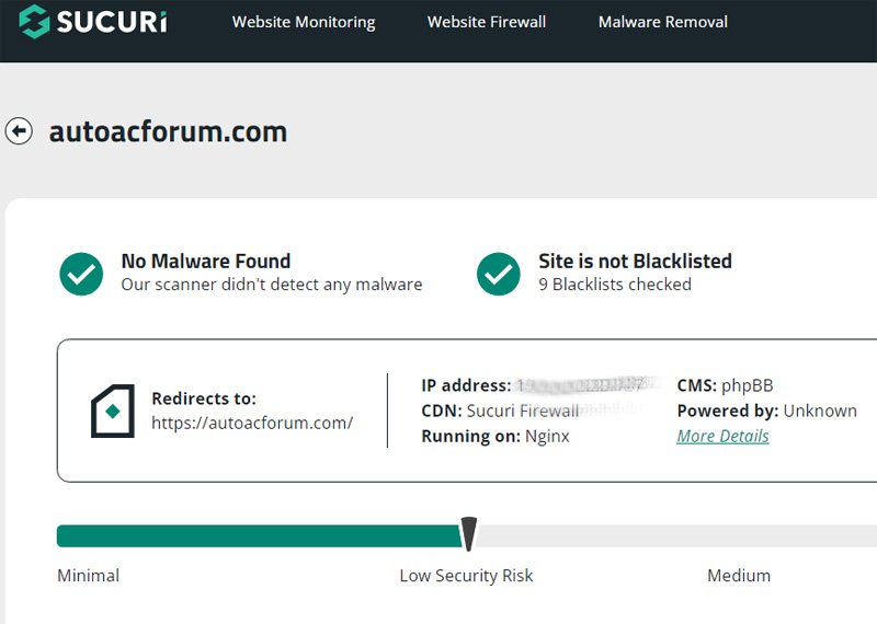

By the way, I now have newer computer with Windows10 and Avast antivirus software, and when I go to the forum site I get the following message, which doesn't come up for any other site. I'll send you a screen capture of that in an E-mail.
Re: 1969 Cadillac Sedan DeVille
Okay. The site should be clean according to the monitoring service.
- 02282024.jpg (100.18 KiB) Viewed 13837 times
