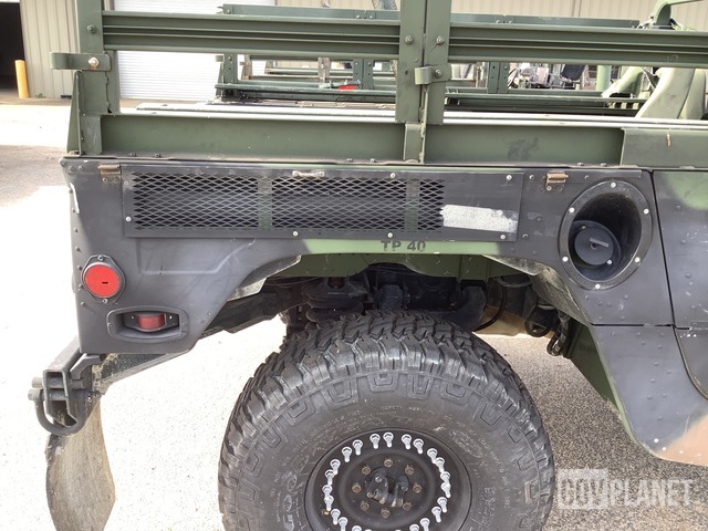

The condensers are in the rear fenders, one each side so that is allot of hose/lines

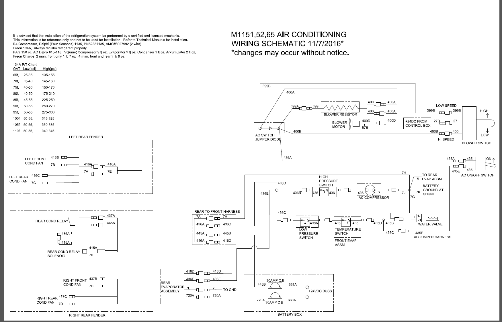

I was able to confirm, and found the original wiring diag. does not look that bad in schematic form but the harnesses are bulky with a ton of connectors in them.

Wow. Run an R4 compressor, then put a crap system in for the grunts. Typical .gov contract decision.

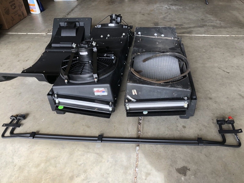

I don't know what the OE front evaporator looks like, but you might want a bigger one in the back. Got any pictures of this equipment?
Re: Newbie, installing "custom" system
Here are the condensers one in each rear fender, with the hard lines that go between them, the condensers are up right, one does not have fans, there is only one closeout shown that goes under the condenser but is actually upside down, and a picture of the grill on the outside of the fender not.
I will find the rest
