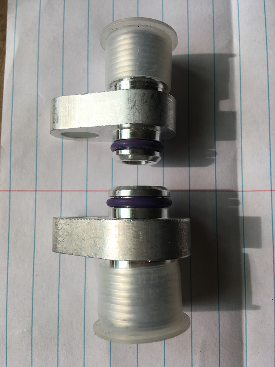

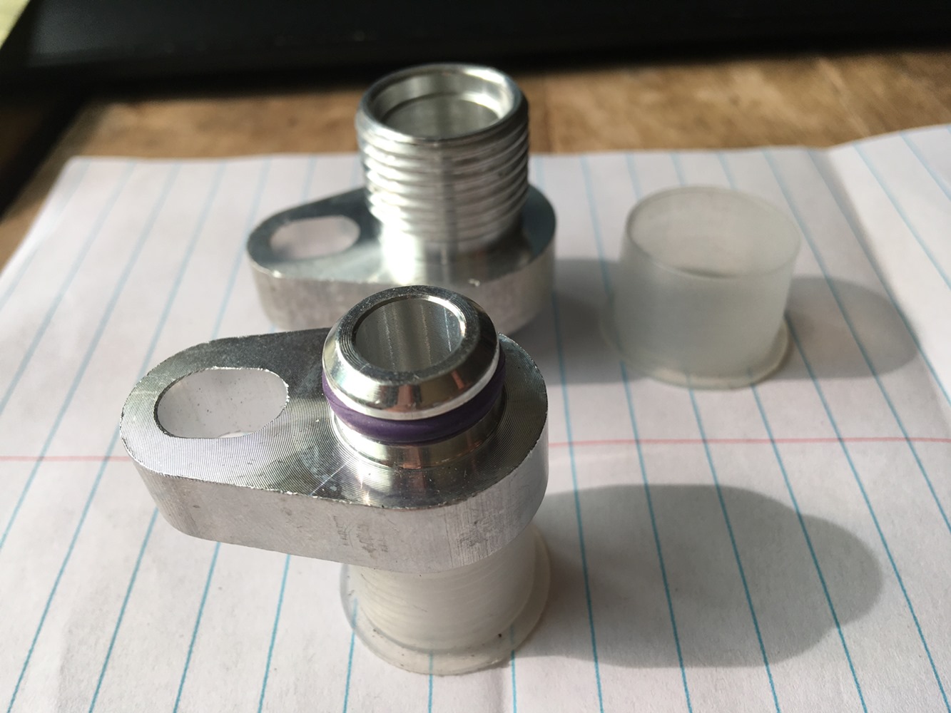

Some folks have cannibalized the pad (manifold?) fittings for the new compressor from hoses for the next gen civic. While that works, it adds clocking of the fittings to the natural bend of the hose, worst for the discharge line since both ends need to be clocked relative to each other. Here’s a pic of those adapters which reduce / eliminate the clocking requirements.

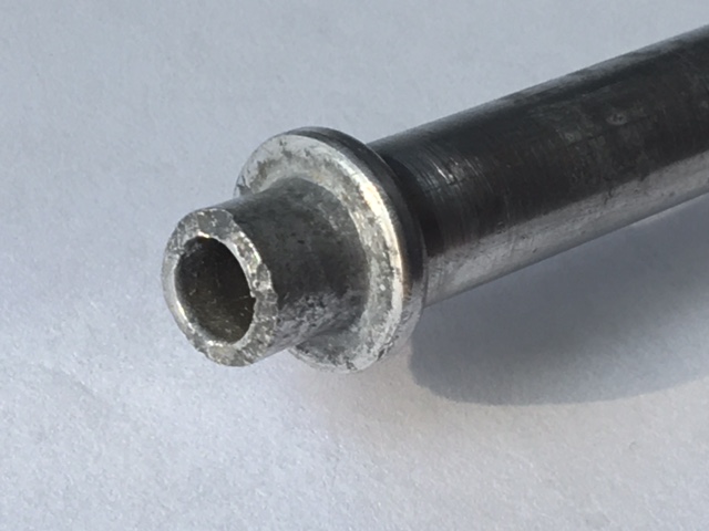

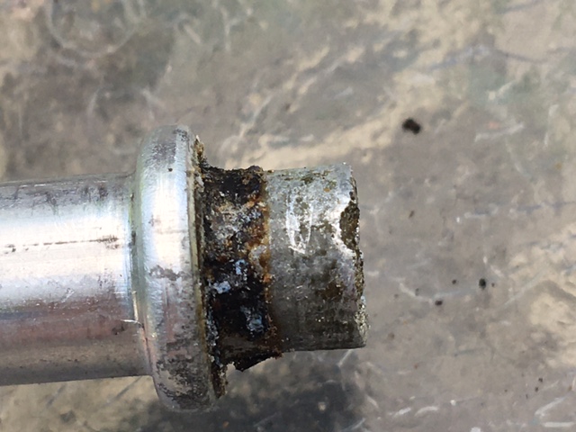

I mentioned that the TXV equalization tube was completely blocked with hard crud. I forgot to mention that in cleaning up the fitting end of the liquid line to the TXV that the old o-ring was also fused to the liquid line hard as a rock. After cleaning it up, I think that line end was corroded, possibly by galvanic reaction between the dissimilar metals of the line and TXV. The line itself has a rough surface that I think could cause leakage around the new o-ring even if try more herculean polishing efforts. Here's pics of before and after. Do you agree replacement makes the most sense?
