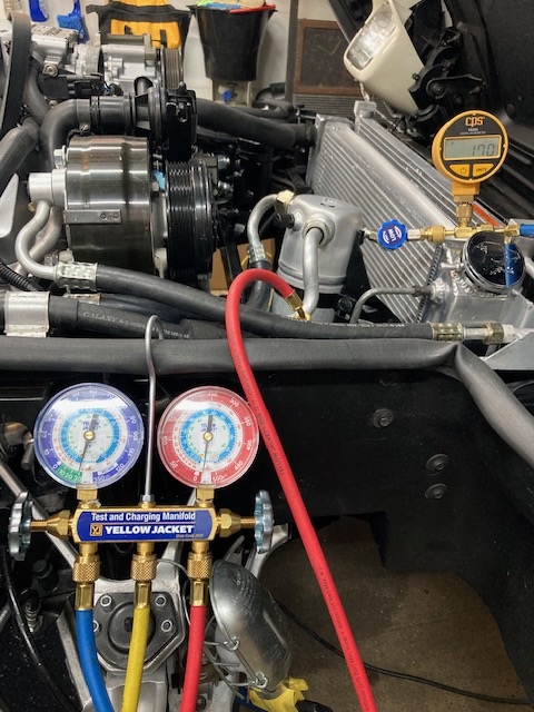

As far as the evap icing, could this also possibly cause the accumulator to ice also?
I started pulling a vac at 2:30 and @ 3:00 this is what I ended up with
At 4:30 it was reading 190 microns
When I checked at 7:20 it had risen to 220 microns.
Should I once again puff in about 20 psi of refrigerant and do a leak check with the sniffer and then evacuate again? Also break the vacuum with a small amount of refrigerant, NOT room air?

I don't see any icing in the photo. But to achieve a reading of 170 microns after only 30 minutes of pulling a vacuum seems extraordinary and makes me wonder whether the valve between the micron gauge and accumulator is closed.

I started my evacuation last night at 8:00 pm and let it run overnight. When I checked this morning at 9:00 am, I am sitting at 110.
I watched it for 5 minutes and it had rose to 140.

It would seem you are OK. There is nothing shabby about 140 microns
