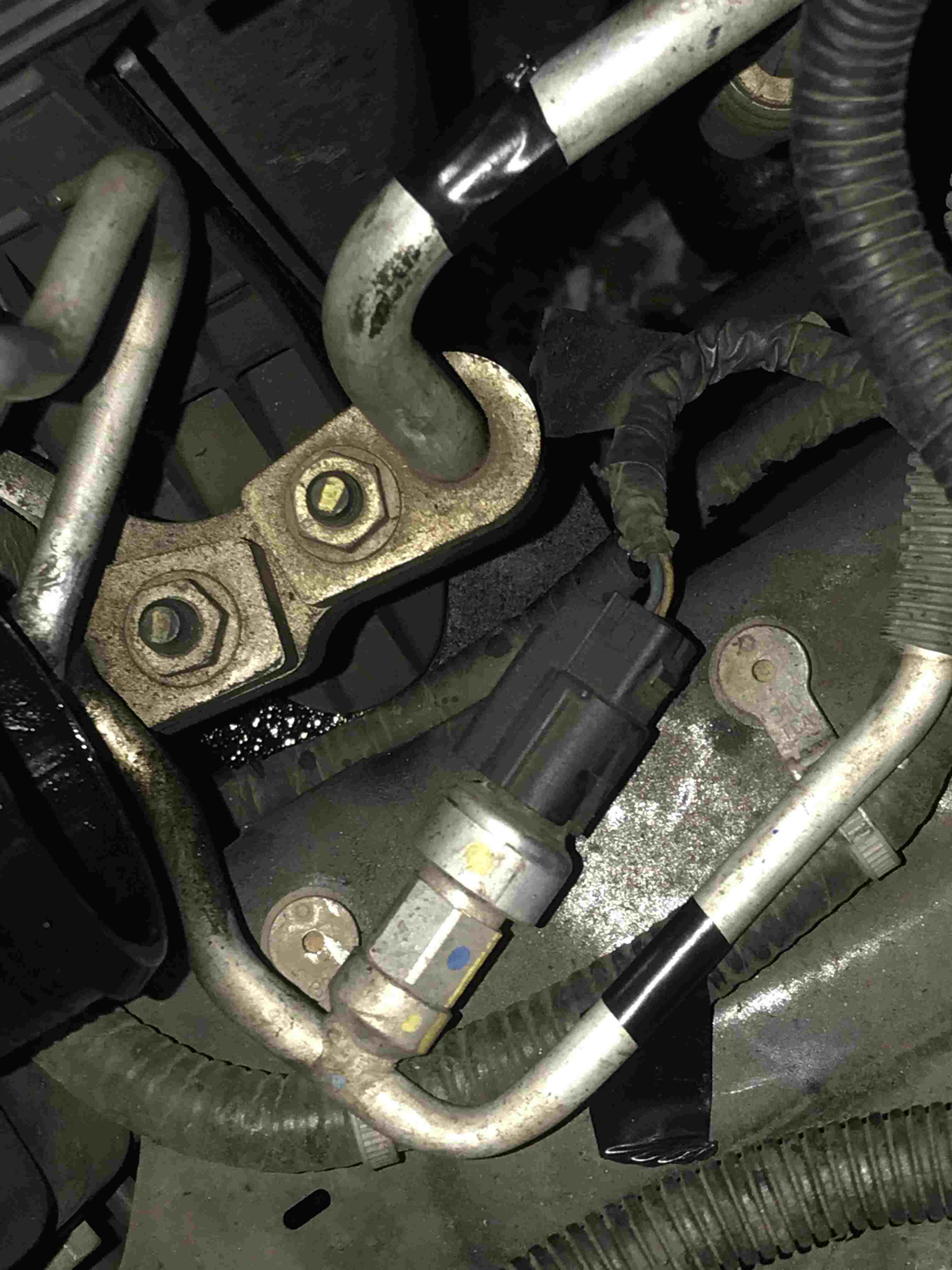

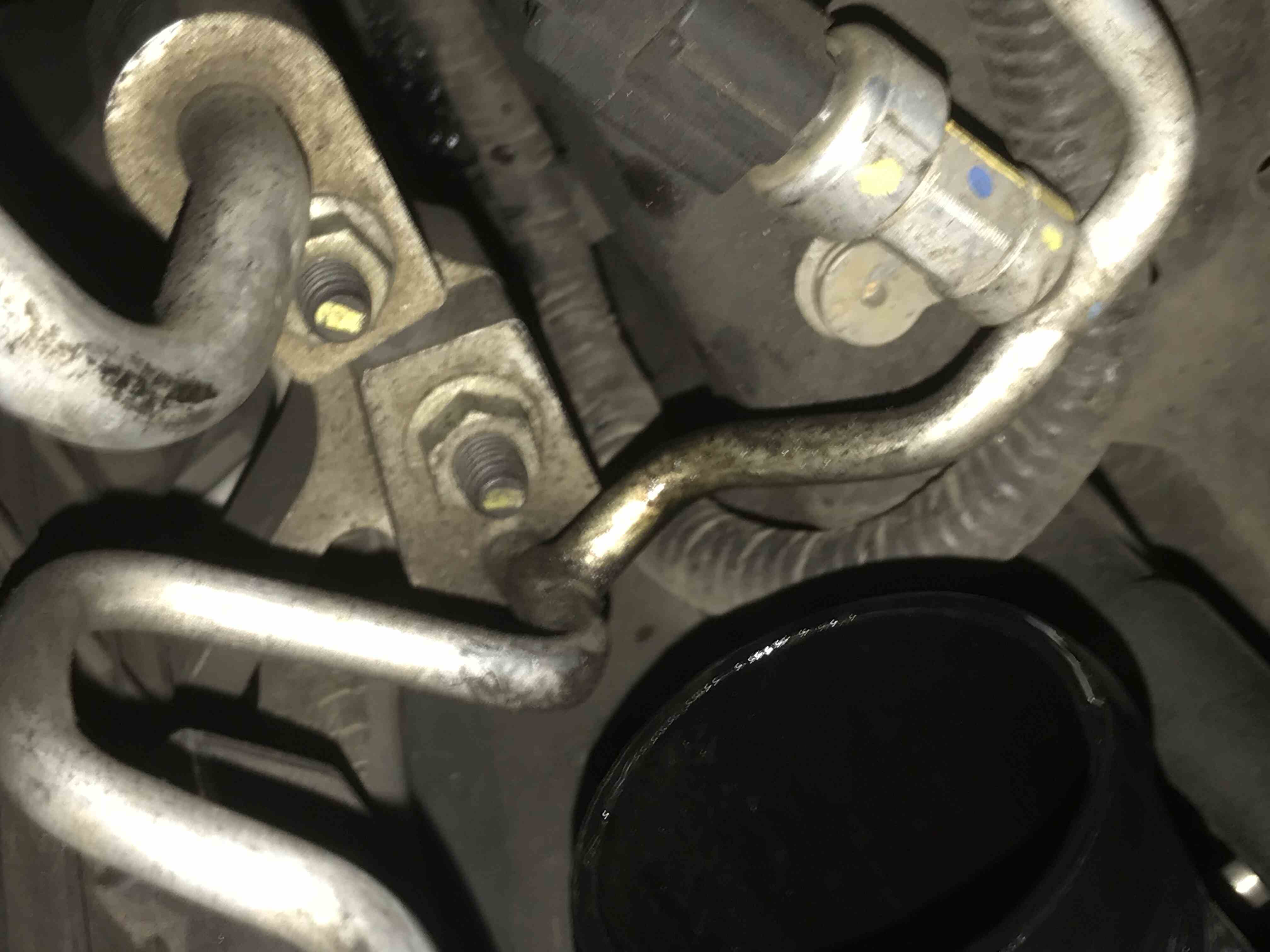

Before I post the readings, as per request, here are some photos showing:
1. The condenser outlet junction that branches into two pipes
2. The black insulation tape placed on the condenser I/O from which temp readings were taken

Thank you for the better pix of the piping.
Well one thing for certain, the comp is OK since it can produce a pressure of 400.
Your pipe I/O to the condenser is 141F in and 107F out for our USA readers. That is about the 30F drop we seek. BUT the pipe in should be considerably hotter, to the point that you can barely touch it. So I am still not sure if your readings are accurate.
