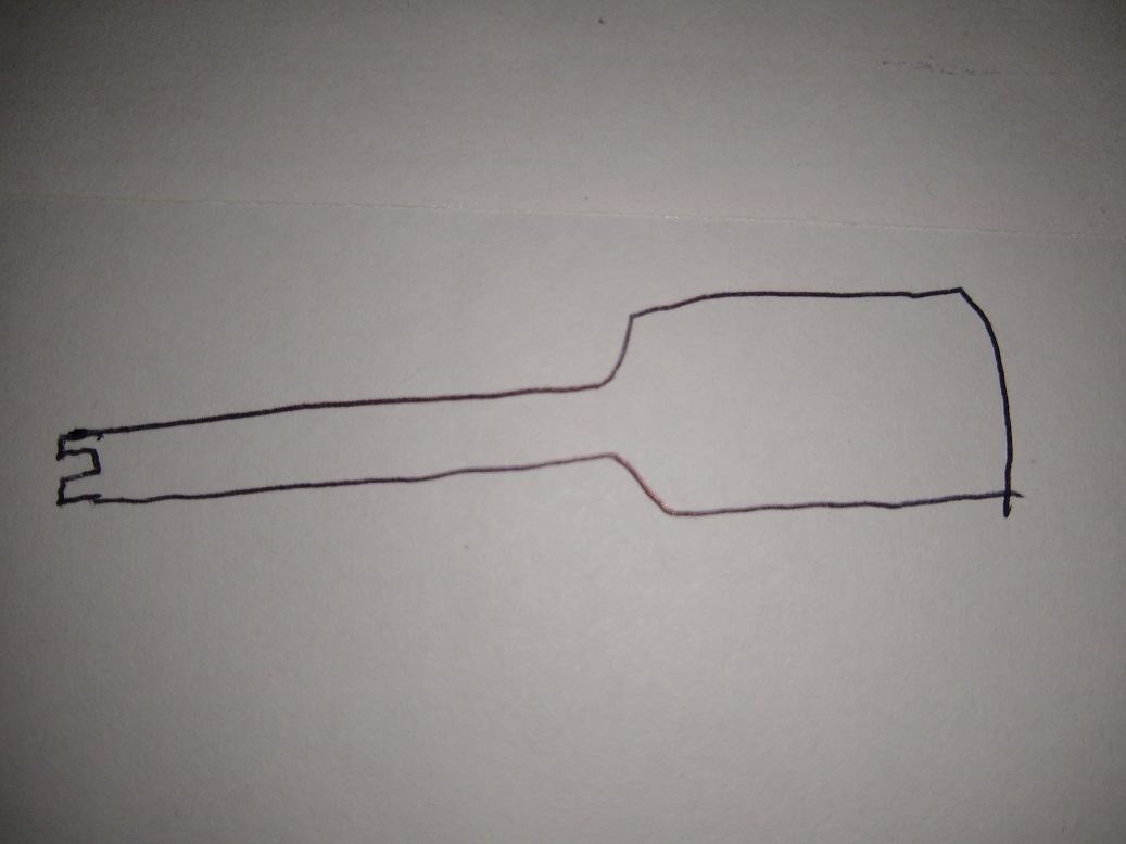

Just for info, the valve core remover tool you posted is the kind that is used without recovering the system, I had in mind something way simpler that is similar to a stubby screwdriver with a notch cut in the end.
I am not sure what you posted could be adapted to a 3/16 fitting.
But regardless, to change the comp you will have to recover the system, so the fancy tool will not be needed
Here is the regular valve stem tool
Re: 1991 Mustang GT w/ R12 - need help
Posted: Fri Sep 02, 2022 6:05 pm
That's funny. Youtube has a video on how to snip an image instead of linking to a page.
Posted: Fri Sep 02, 2022 6:21 pm
Tim, I thought my artwork was rather well done! Dave
Posted: Fri Sep 02, 2022 6:27 pm
tbirdtbird wrote: Fri Sep 02, 2022 6:21 pm Tim, I thought my artwork was rather well done! Dave
It was, snipping for those that don't have your talent.

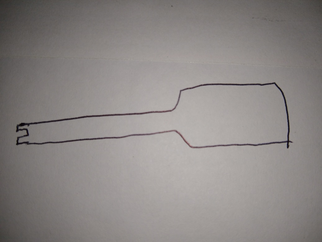

This is all you need for a core removal tool
Valve Stem Remover Tool.png (49 KiB) Viewed 15688 times
Yes, you can use the TIFF engine off, better that way in case the engine fan would blow the leaking refrigerant away. Refrigerant is heavier than air, so sniff at the bottom of fittings. To sniff the evap (in car unit), go underneath car and sniff the drain tube.
