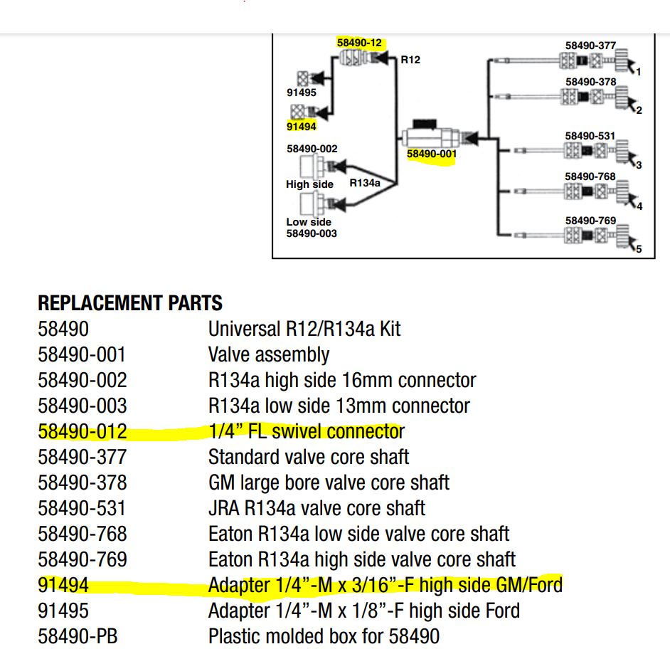

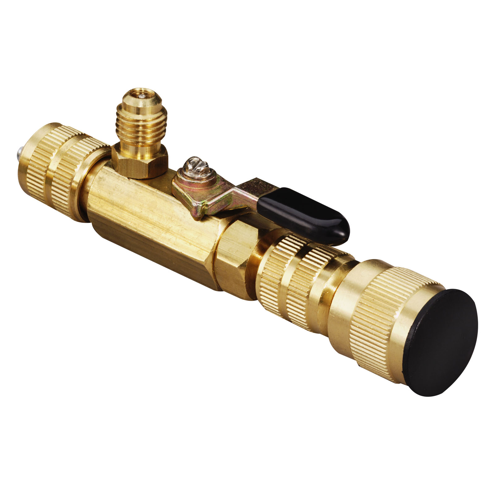

Just for info, the valve core remover tool you posted is the kind that is used without recovering the system, I had in mind something way simpler that is similar to a stubby screwdriver with a notch cut in the end.
I am not sure what you posted could be adapted to a 3/16 fitting.
But regardless, to change the comp you will have to recover the system, so the fancy tool will not be needed
Here is the regular valve stem tool

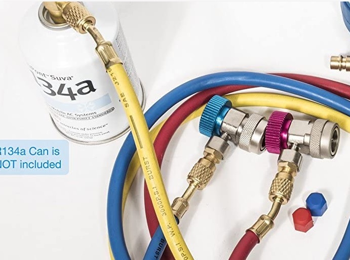

Attaching pics of the gauges I borrowed and the valve core removal tool and adapter that I **think** would work on the high side charge port. Would really appreciate the confirmation that I am on the right track here. In this adventure, I have also picked up a used TIFF-5550A leak detector. I am assuming just use it with the engine turned off?
If there are links to the items I need on Tim's site - please be all means, send them my way.

This is all you need for a core removal tool

Isn't it a better idea to replace these schrader cores with the tool that won't allow the refrigerant to be lost?

Also, as stated, I am pretty sure that "hot swap" core changer will not fit the 3/16 port.

Where in So.Cal are you located? I'm in N. OC and have a set of R-12 gauges I would loan out if you need them as AutoZone does. Just a thought.
